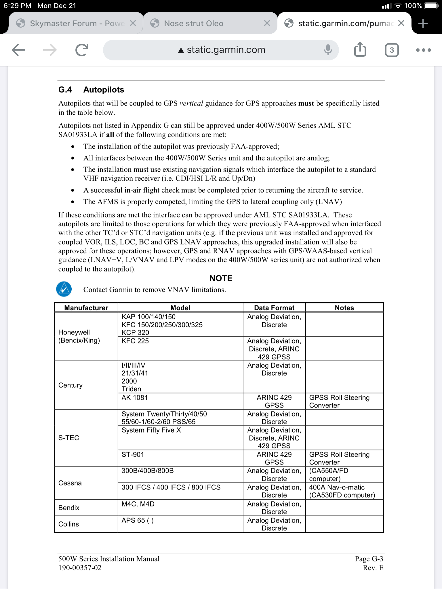

The 400A can be used for LNAV minimums, however, LPV minimums, are not authorized. Attached is a page out of the 530W installation manual rev E.
