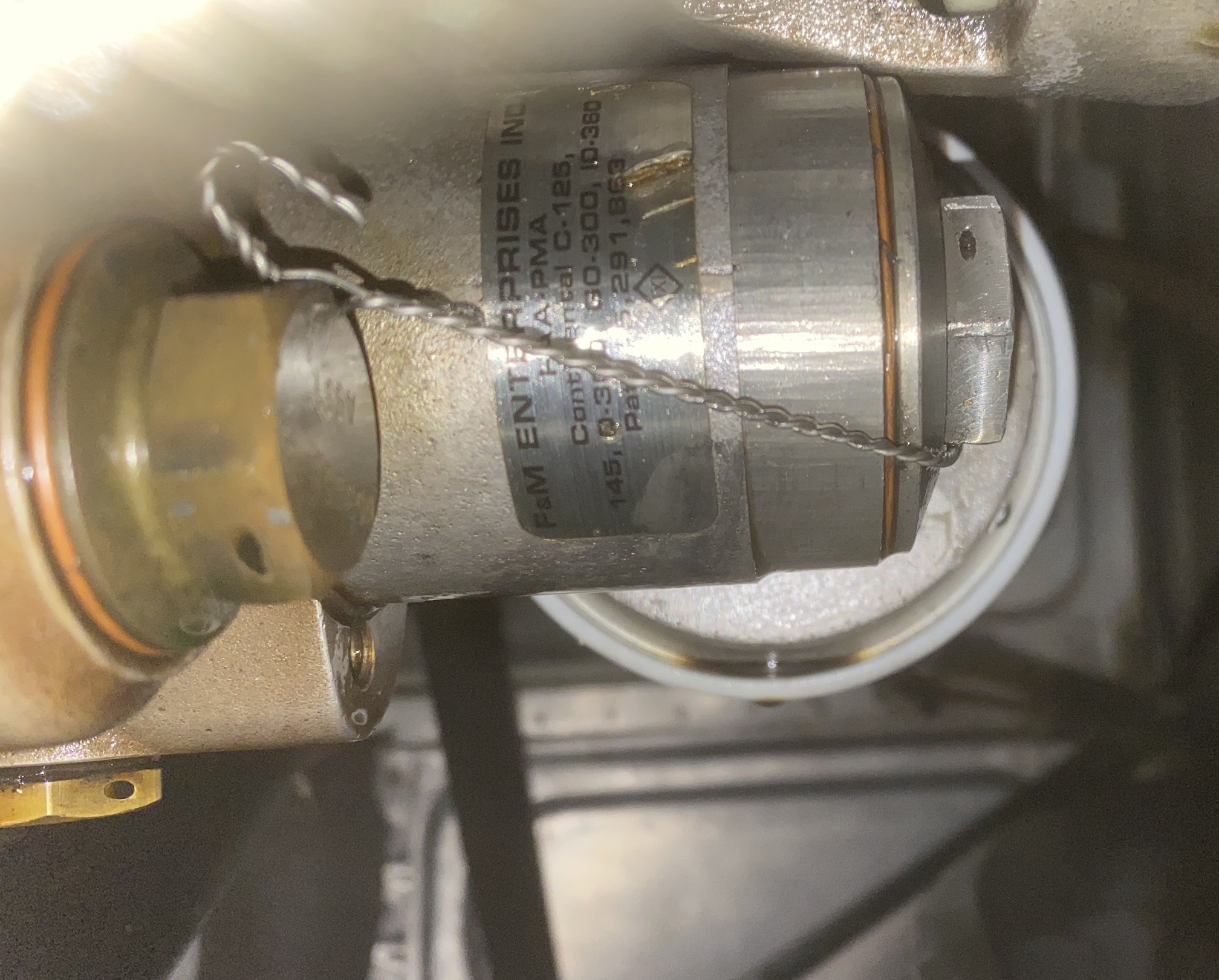

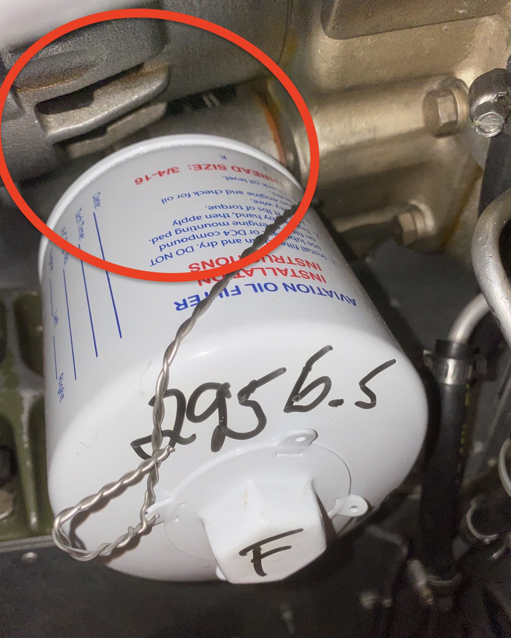

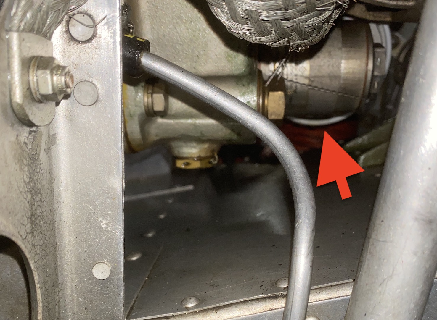

Many of you may have these Oil Filter Adaptors on your engines. I have them on my engines. I have seen problems with these filter adaptors and have seen results of aircraft loosing all oil and making safe emergency landings. This is now a known issue and therefore this Service Bulletin has been released. Look it over closely to be sure the oil filter adaptors are performing correctly.
NTSB is researching this issue and will make some kind of recommendation to the FAA about these adaptors. Originally manufactured by F & M Industries but now owned by Stratus (Tempest)?
