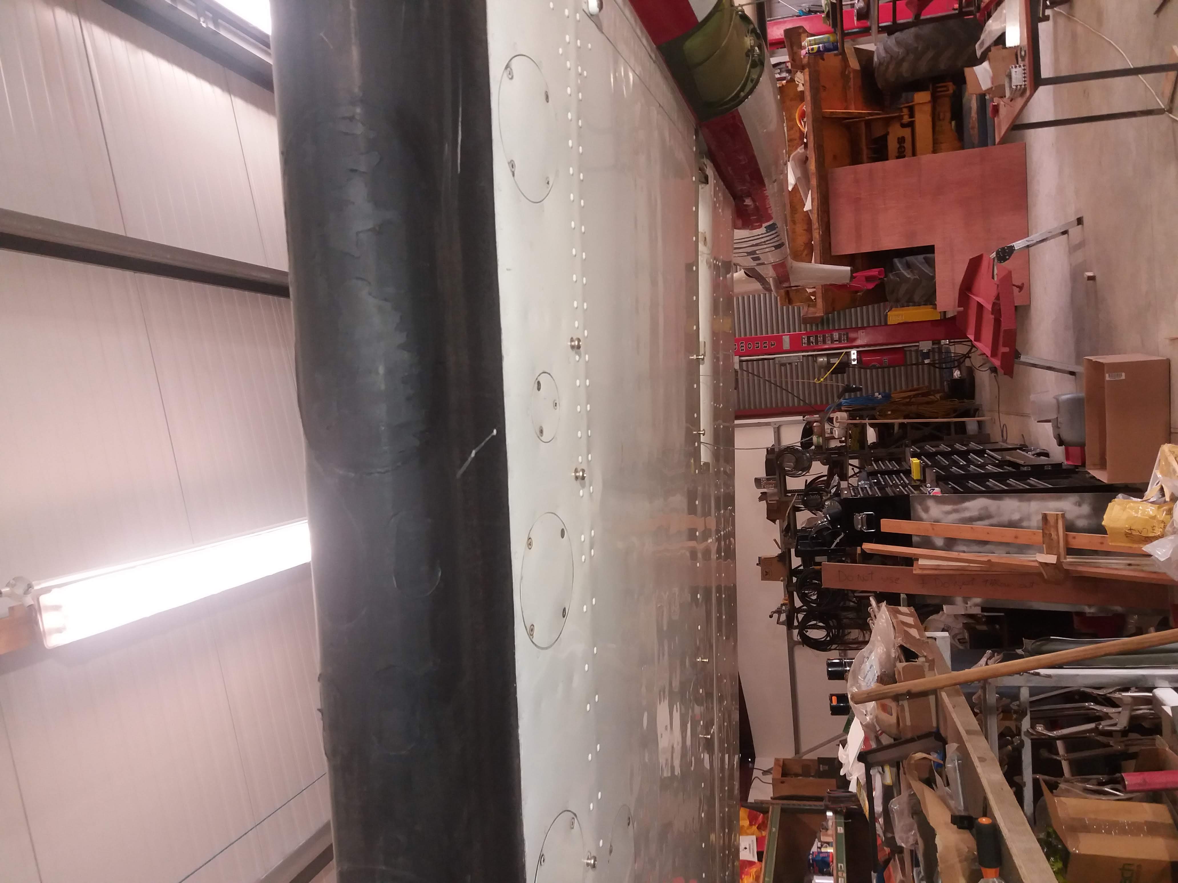

Here's a picture of an FTB337G with the hard point screws visible. There are two in front just forward of the main spar and two in back just aft of the rear spar. This is the inner hard point; 3 screws of the outer hard point are visible on the left side of the photograph.

I don't think that's a milirole. I see inspection plates, not hardpoints.
That's an FT337G, not an FTB337G. If you're looking at the right side, you can tell because it doesn't have the windows in the lower half of the clamshell door.
