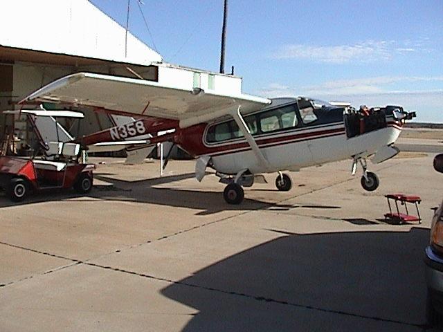

This works real well when working in the area of your nose gear.
The plane is over-center setting on the PVC legs, with a safty strap over the boom down to the golf cart. If you need to know how to unlock the nose gear so you can swing it up by hand, just ask.
Fred N358
