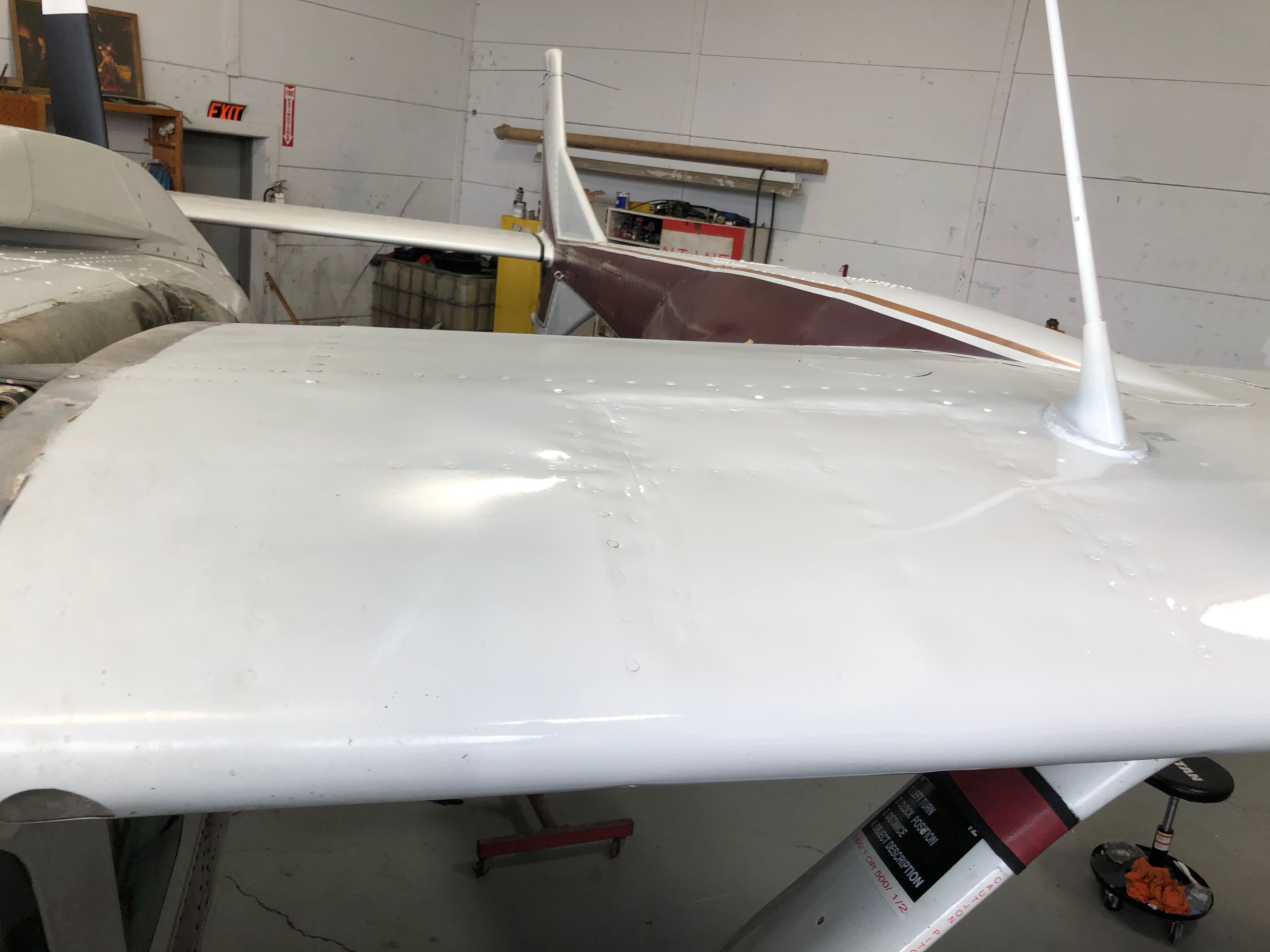

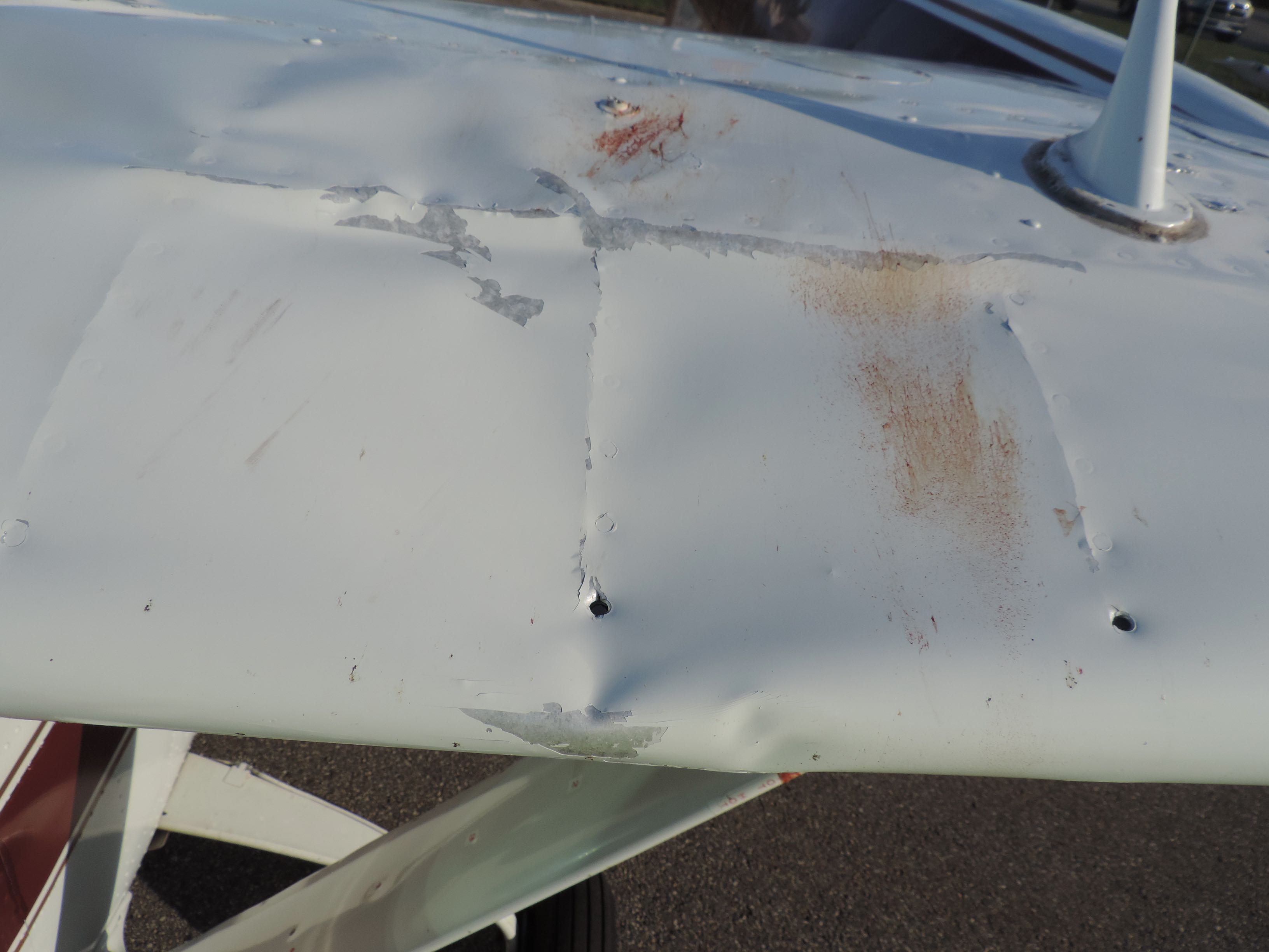

We had a bird strike a week ago and are trying to source out the ribs. Waiting on Don N to get back to me but if he doesn't have the parts we need, does anyonw know where we can get them?

Gord. Any competent aviation sheetmetal mechanic can repair that damage WITHOUT replacing the ribs! The ribs may require patching with a re-enforcing angle. The leading edge will have a re-enforcing strip around the cut out and an inserted piece of the cut out(replacing the damaged leading edge skin) with a double row of Cherrymax (Blind rivets). Fairly simple repair. As a 20 year US Army sheetmetal mechanic, I've done this type repairs on Army helicopters, as well as fixed wing aircraft. You can check out AC 43-13-1B FAA circular for aircraft repairs AND Cessna structural manual. Hope this info. helps.

Thanks for all the input. My mechanic was in fact able to repair the damage just as one of you indicated. 3weeks to the day.

Your mechanic did a great job! I don't think the "average" A&P would have been able to make that repair.
