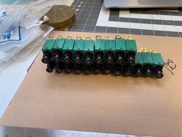

The 8 amp breakers are no longer available. The current 7.5's are the correct replacement. The original breakers have a huge variance in their ratings. That 8 amp breaker may trip between 5-15 amps. I find they work best in the garbage can.
I will be eager to follow your updating process. Below is the start of another project.
File Type: jpeg 60117043579__DD01DE4C-D860-43E6-8C5A-B261A5CABB7D.jpeg (101.9 KB, 2510 views)
