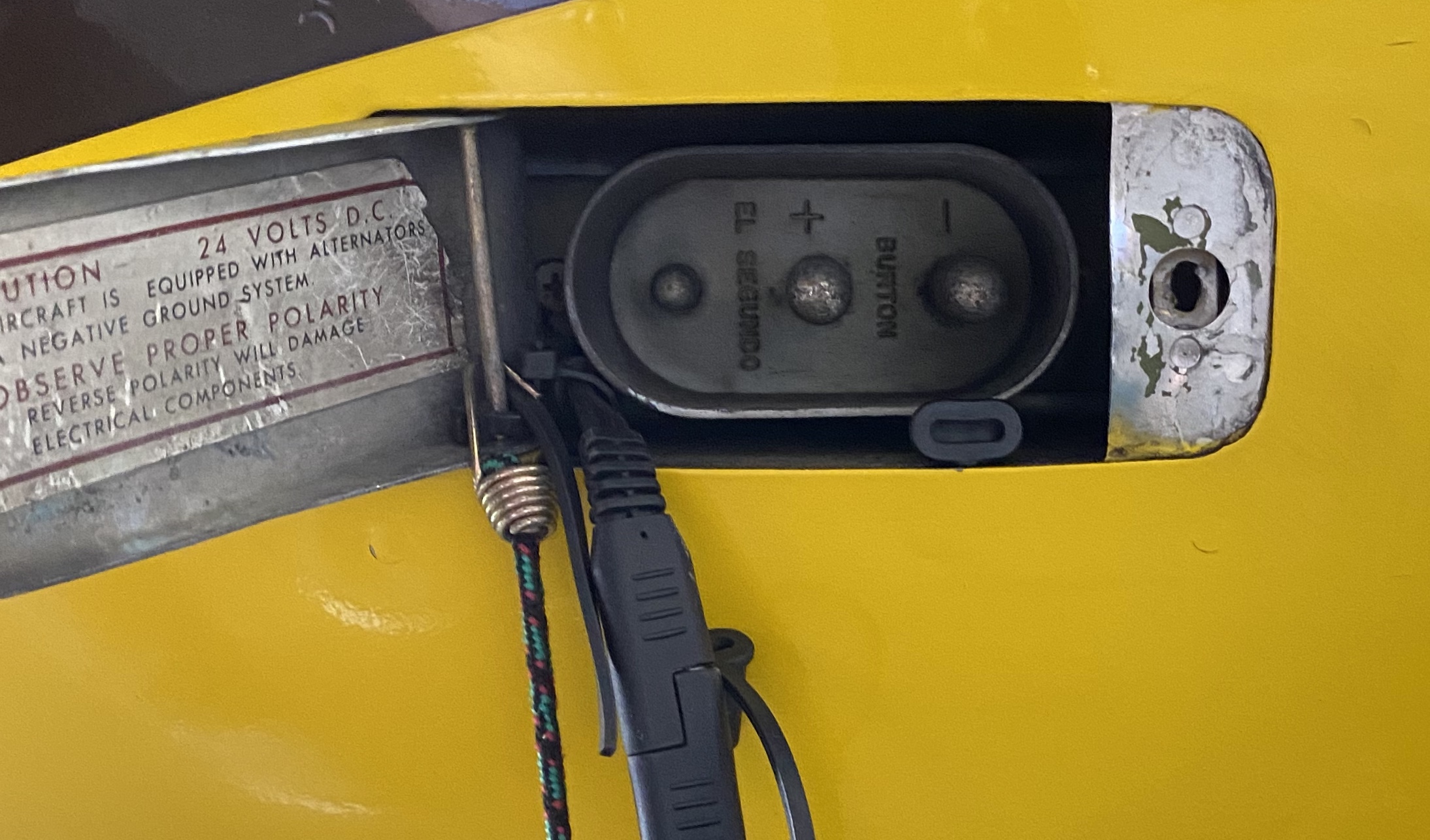

How are you connecting your battery minder? Are you popping the cowl off and opening up the battery box to attach alligator clips, or is it possible to hook something like this up to the GPU port?
https://www.aircraftspruce.ca/pages/...jumperplug.php
Unread 09-04-20, 02:53 PM
Mine is in the GPU door. Works great
File Type: jpeg 3C271CCE-9A83-489D-8241-19D05ACBBC5C.jpeg (733.6 KB, 9395 views)

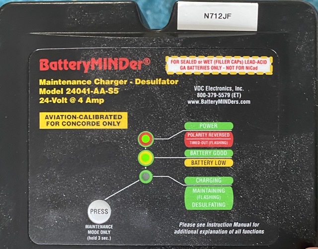

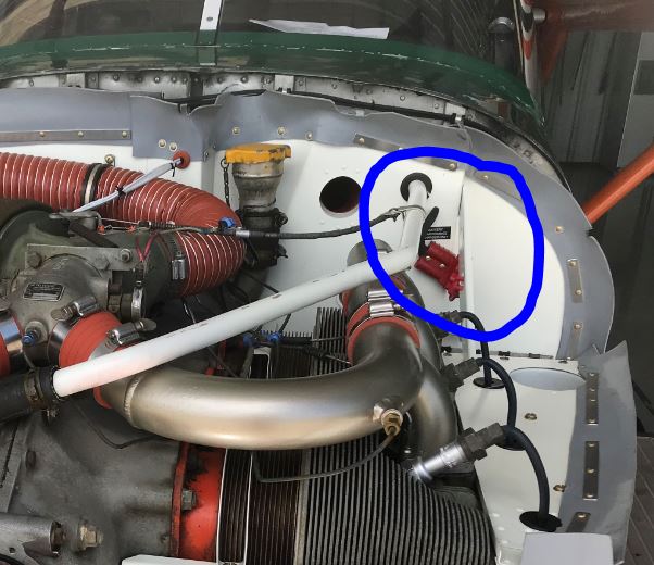

Battery Minder
I installed the interface kit on my engine baffle - accessible through the oil dipstick door on the front engine. Simple log book entry.
https://www.batteryminders.com/batte...fied-aircraft/
