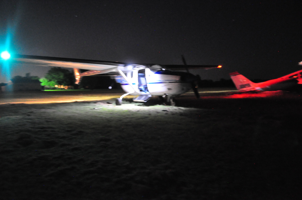

Thanks! I checked the fuse—looks OK. The courtesy lights in the headliner above the 2nd row appear to work, as does the dome light. But no voltage on the wires headed towards the clamshell door, and the pilot map lights are inop.
On the plus side...the panel lighting is terrific!
