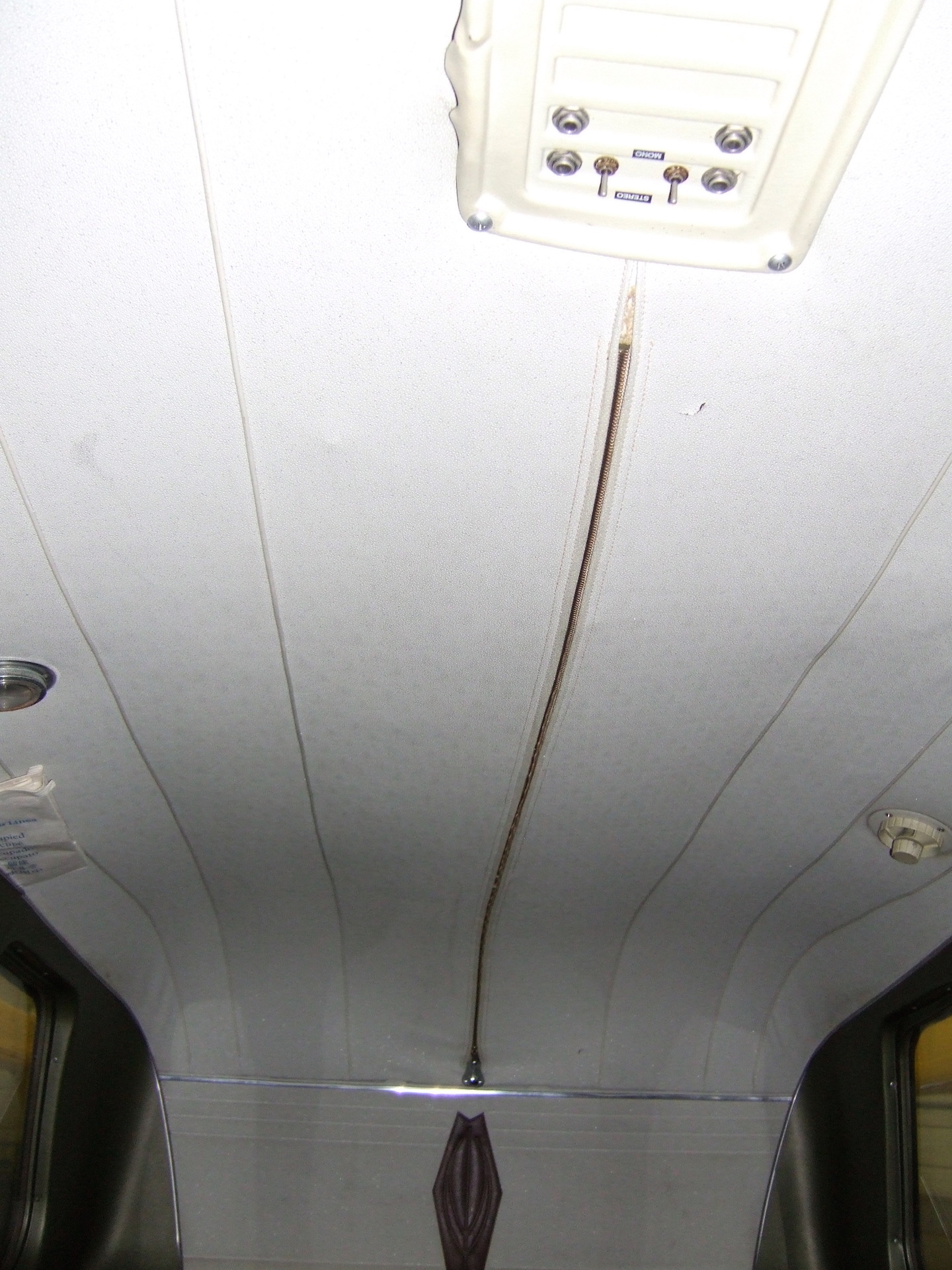

If I did mine over again I would probably use these on the side wall. Pretty common solution. Currently mine are overhead in the middle. It's ok but the cords do get in the way when entering and exiting
https://www.aircraftspruce.com/catal...ickkey=3018942

Thanks much for the picture! I have not seen them mounted in the ceiling like that before. I had the example mount you sent in my last plane....fit right inside the ash tray area perfectly. I am thinking the side walls as well. I have to replace my side windows, so that would be the perfect time to install the jacks in the side panels.
I have built in O2 and I think that system and gauges takes up the space you have your jacks located.

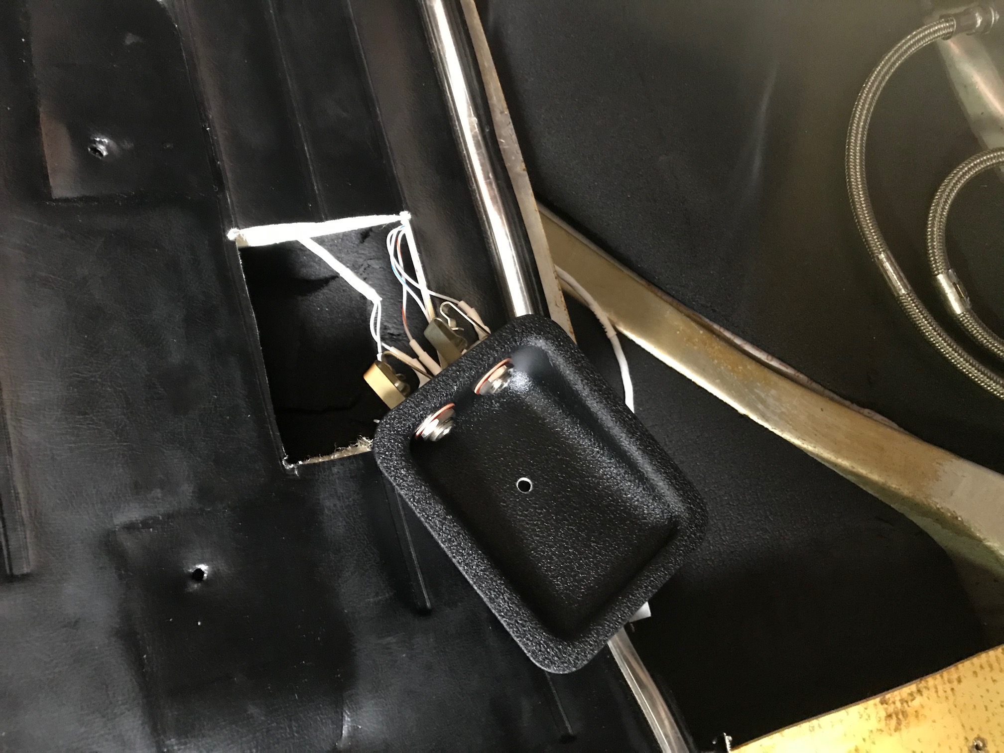

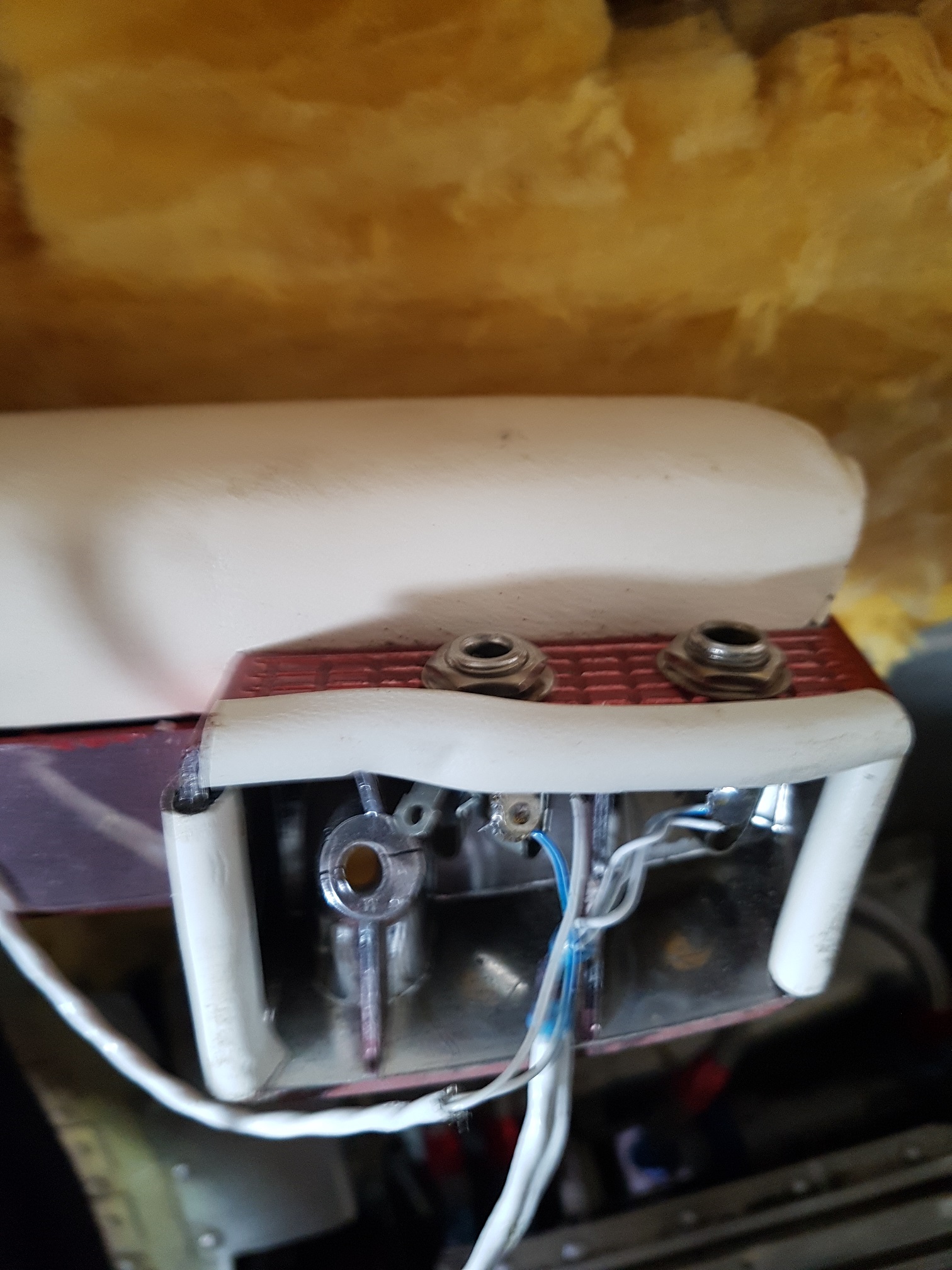

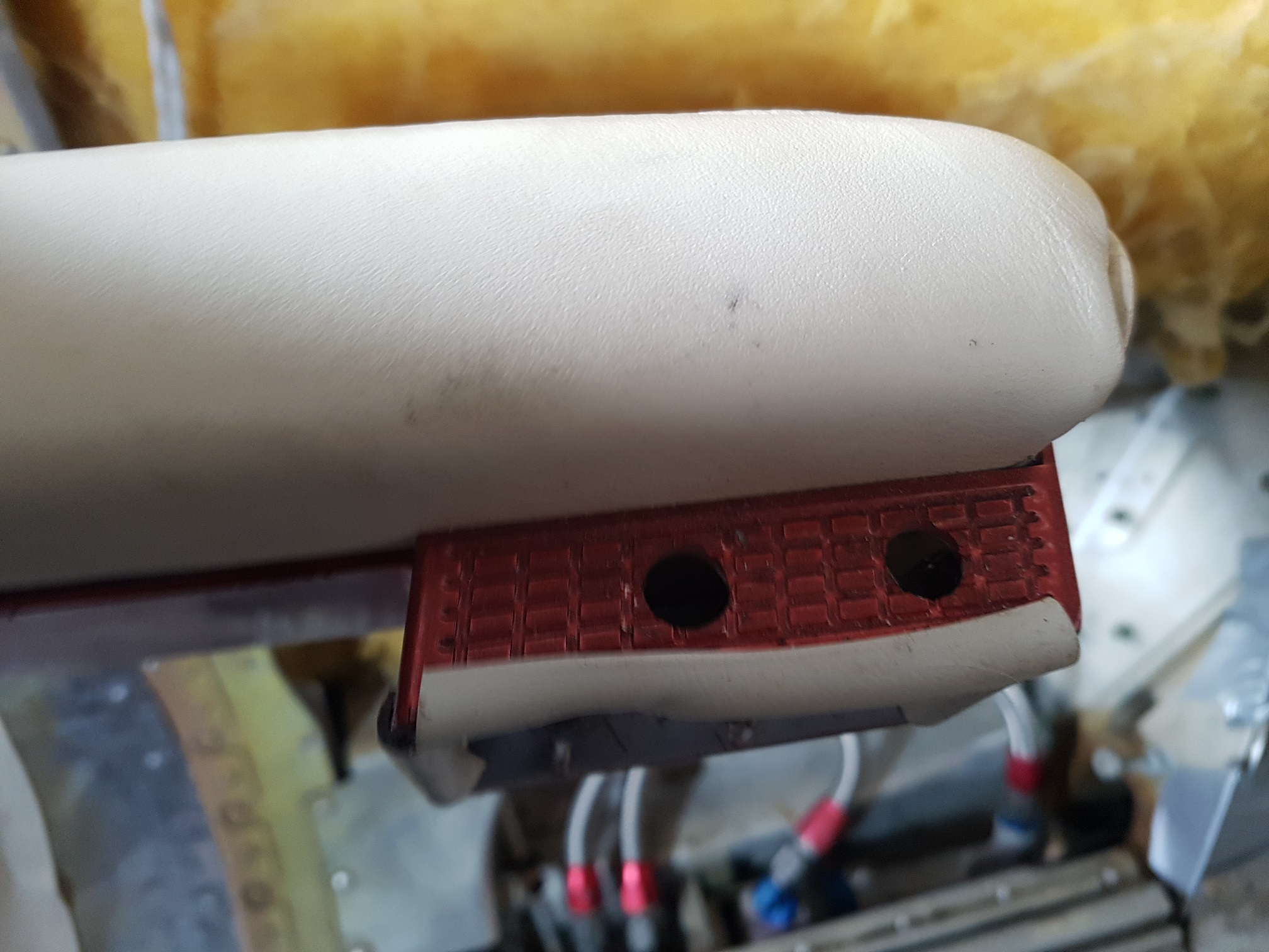

Hi Tom,
Here is a few pictures of my installation I am currently completing on the middle row jacks. I am installing them just under the arm rests - seemed to be best location for when seated and will not interfere with passenger, seat or egress. For the last row, I mounted on the bulkhead - lower portion, just above the vent to the outside. That one is not recessed. The mounts I purchased from Aircraft Spruce.

Thanks Jeff, I think that is exactly what I am going to go with. The pictures really help out, much appreciated!!

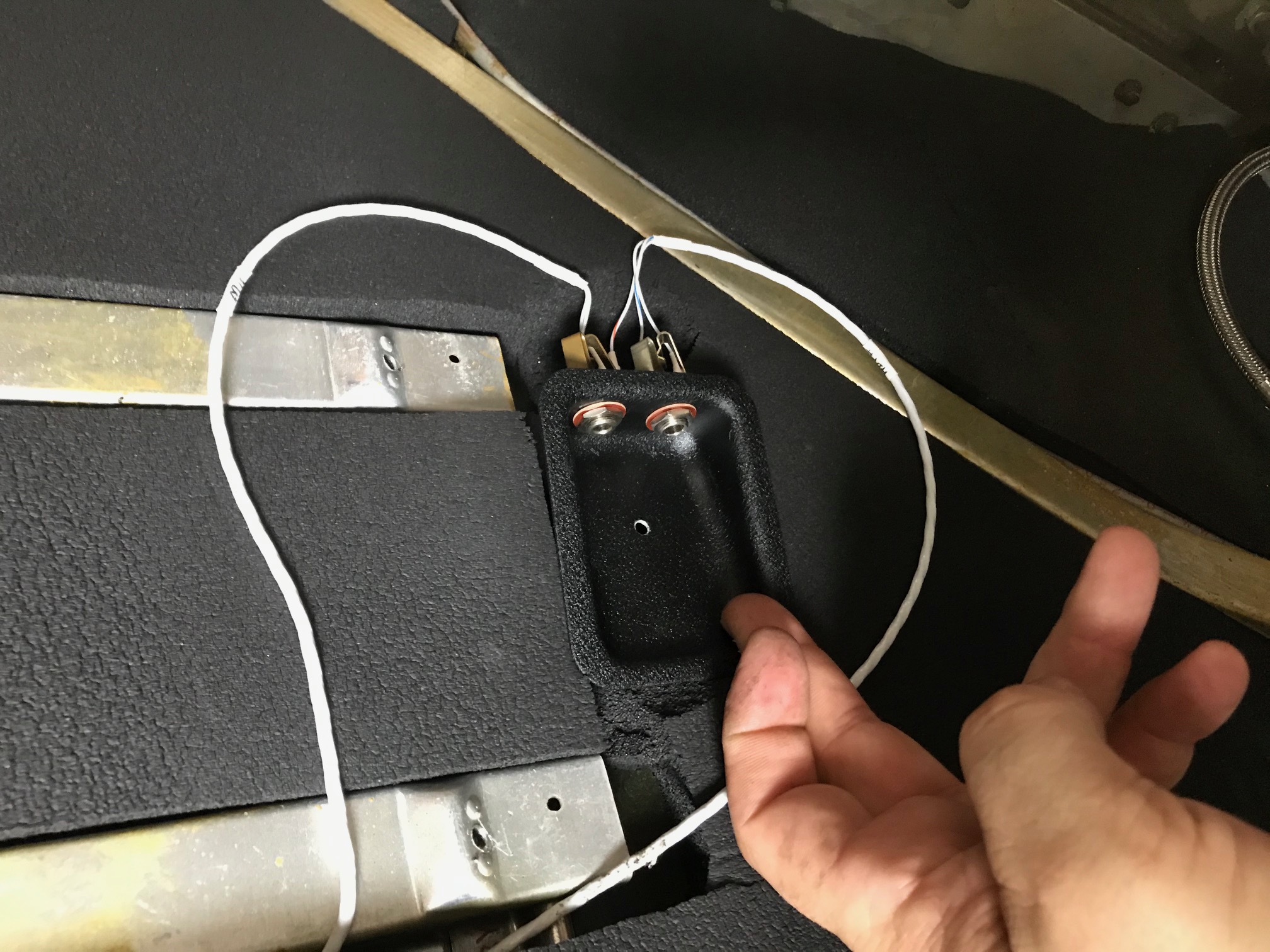

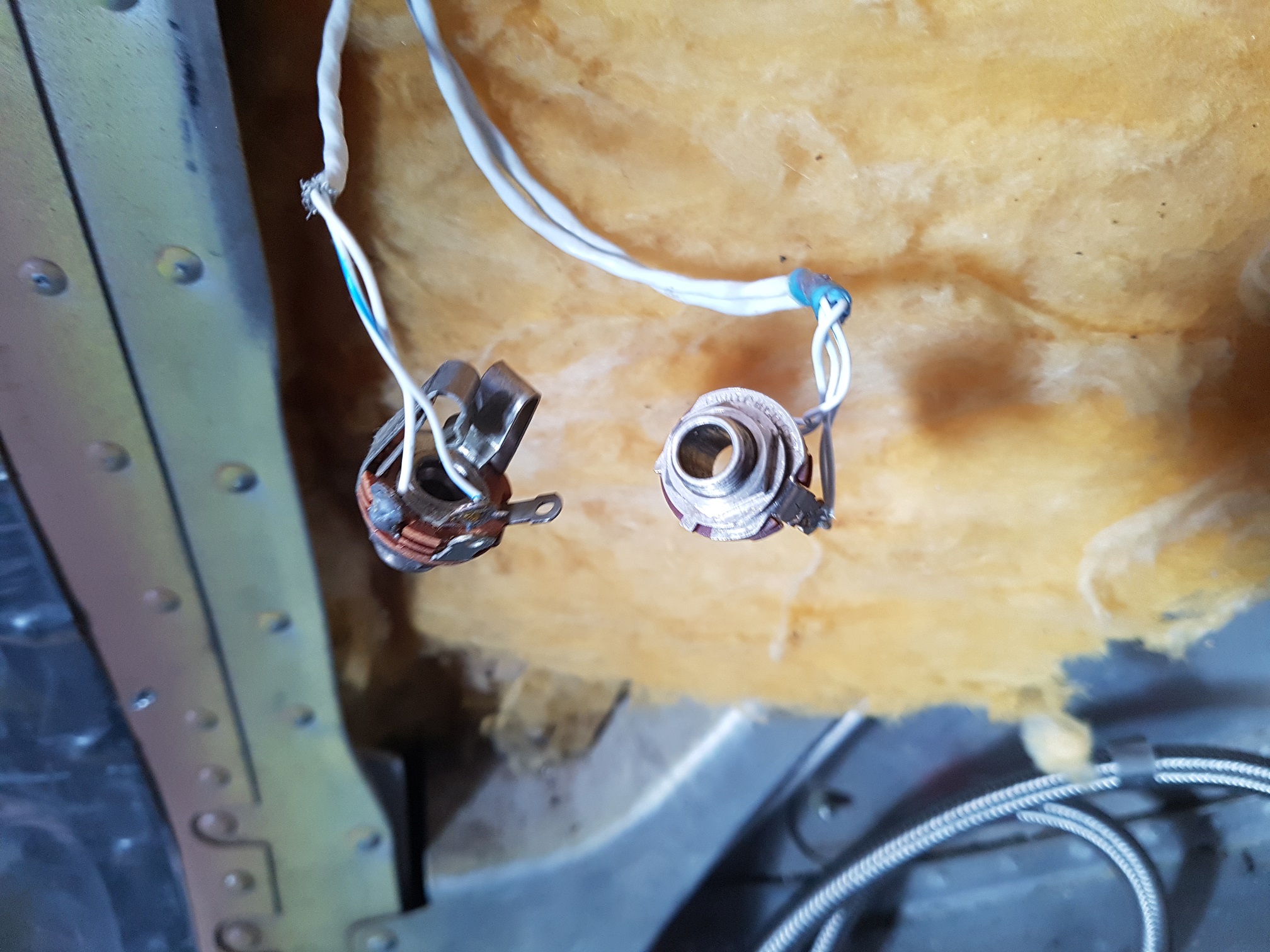

Here are the pictures of my jacks in the armrests
It will only let me post three pictures I posted all the pictures on the skymaster Facebook page

Thanks for the pictures Frank! I have a couple of options now thanks to you guys. I will have to sit back there and do some pondering on what I would like best if I were a passenger. Thanks again guys!!
