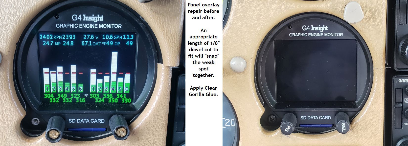

I think I've found a good way to repair the cracks that develop in the narrow spaces of the overlay, between the flight instruments and/or edges. A 1/8" wooden dowel, cut to the appropriate length will almost snap the two pieces together. I applied a little water to the dowel and the layout channel and then Clear Gorilla Glue to the dowel. Worked like a charm. In normal light, not HD camera, the crack is not noticed.
