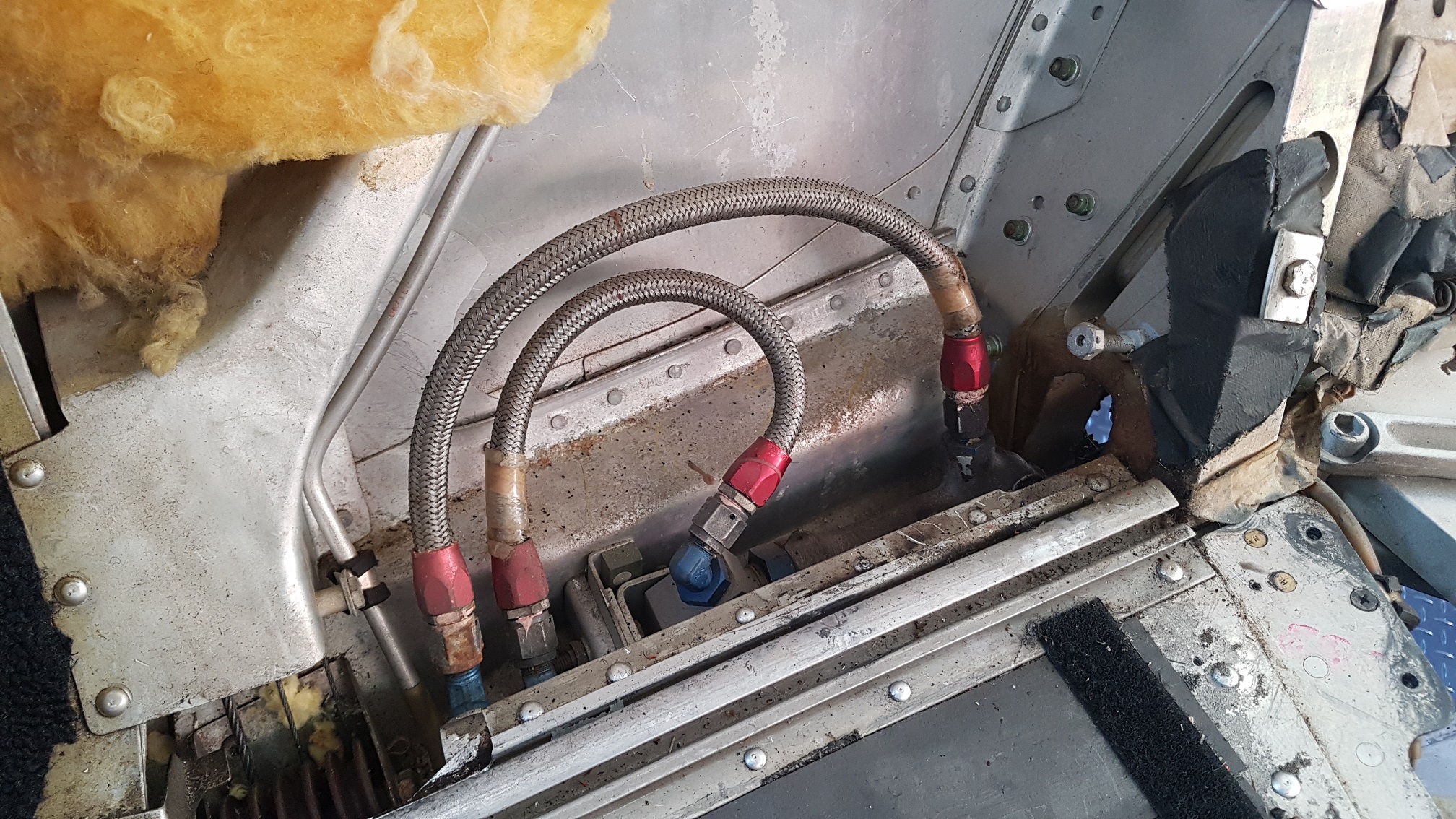

Getting all new all new hoses put on for the gear Do the hoses to the main gear actuators have a braided cover or is this something some one did later
Mechanic was told this hose was not recommended for hydraulic line
Any information would be appreciated
Thanks in advance

https://specialtyhose.com/aerospace-aircraft-owners.htm
Unread 11-20-19, 09:33 PM
Yes, braided cover
