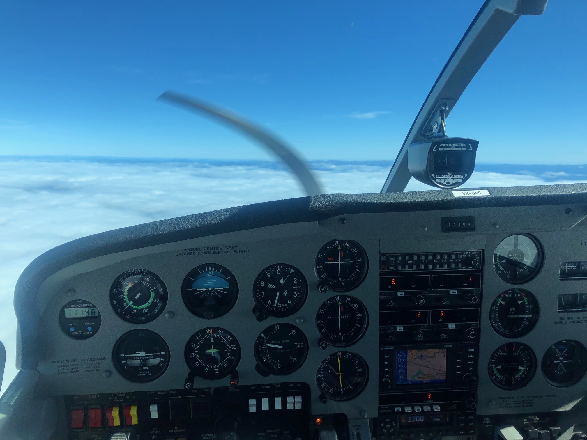

Let me share a recent photo of some flying over a bit of our high country.
