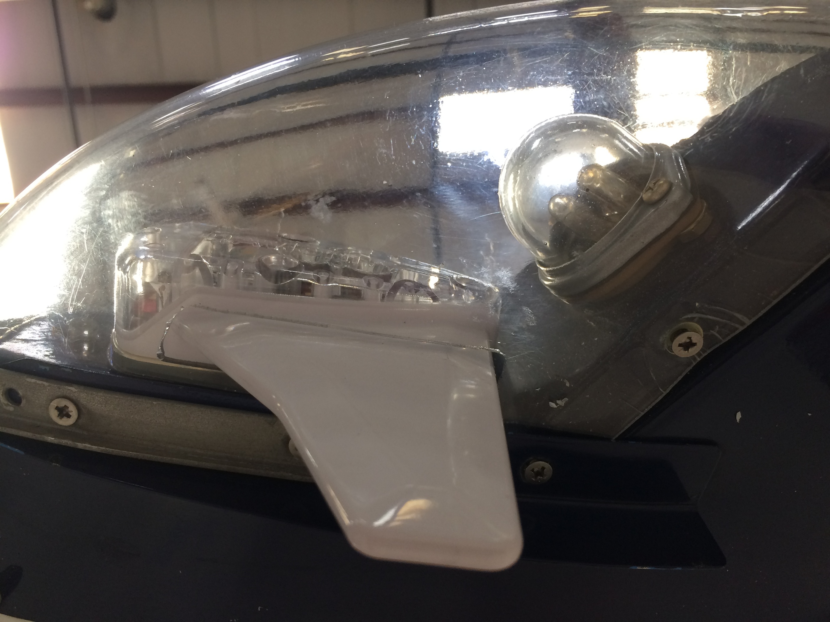

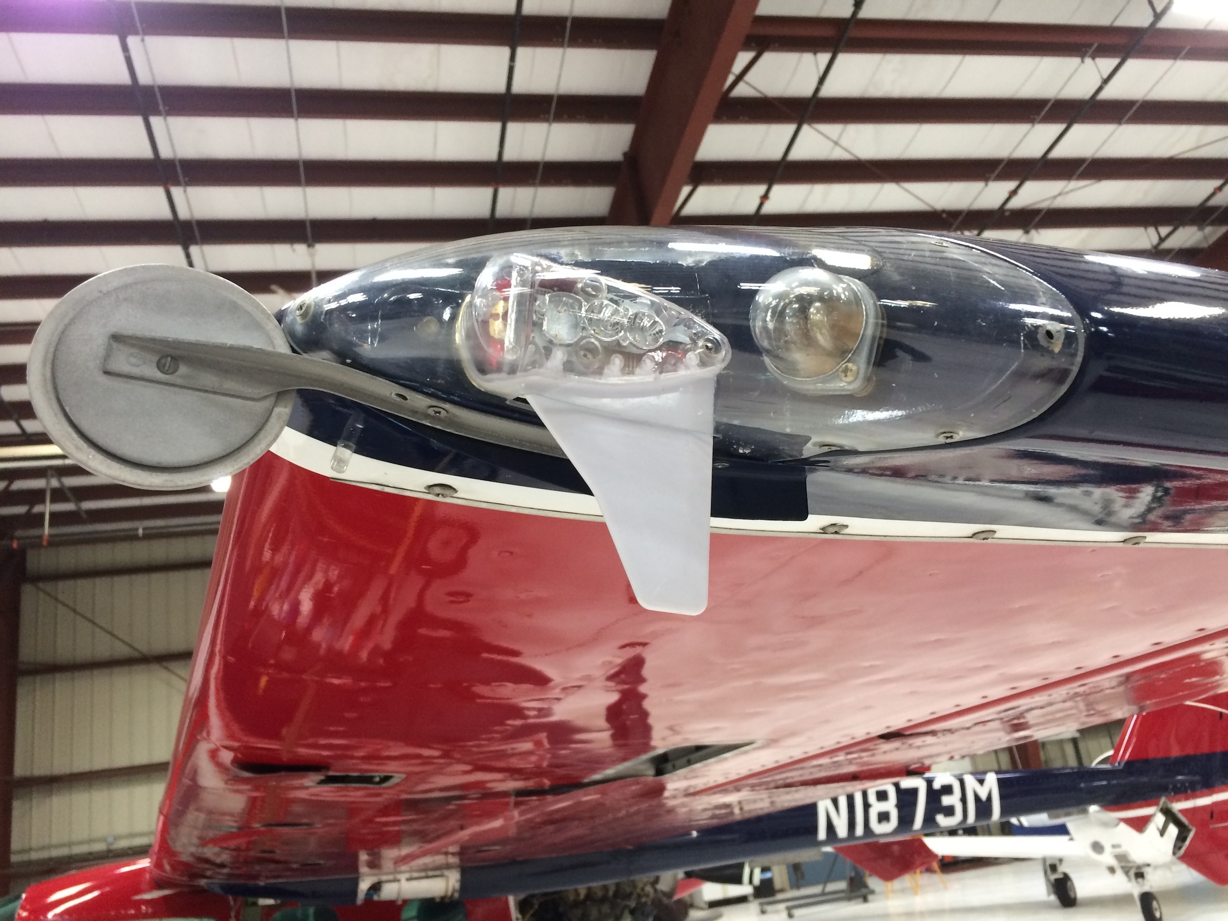

Just had my IA install the u-Avionix SkyBeacon ADS-B OUT 978 UAT on the pilot side wing tip of my 1973 C337G during the annual inspection. After emailing u-Avionix with pictures of my wing tip configuration, they assured me installing the unit under the plastic lens would cause no problem for SkyBeacon. I was also concerned about the proximity to my strobe light immediately behind the SkyBeacon and they assured me that it would cause no interference either. I do have the option of running another power wire to the unit and utilizing the SkyBeacon's strobe light however at this time I chose not to do that for simplicity of the install.
I have not had the opportunity to configure the unit as of yet however the app provided by uAvionix looks very straight forward. I will do this after completion of the annual inspection as well as take a flight and have the FAA email a status report of my ADS-B OUT performance. I'll report back then with results.
The install was very easy with the trimming of the plastic lens cover to accommodate the blade antenna taking the most time. My IA said 2 hours in all.
Attached are two photos....

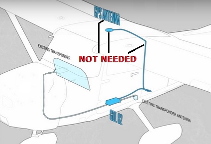

Ed, I noted your installation of a wingtip u-Avionix SkyBeacon ADS-B OUT, but did you consider Garmin's GDL 82 unit? The price is about the same and, for my Skymaster with a Garmin GTN 650 which can provide a GPS source, the installation is just as simple, perhaps even simpler (see image below).
I wonder if you or anyone else has installed the GDL 82 and can report on the installation.

Ernie. I purchased the Garmin 82 but have yet to install it. Waiting for warmer weather. I'll let you and SOAPA members know how it went after the install. I have an avionics guy around here that has installed 6 Garmin 82 in different type airplanes and said they are very simple to install BUT 4 out of 6 failed the FAA performance check DUE TO THE OLDER ENCODER INSTALLED. The old encoders had to be replaced but afterwards the FAA checks passed.

I have flown multiple times now with the new SkyBeacon. The configuration via my phone was very easy and the unit is working as designed. Multiple requests from the FAA's website for ADS-B performance reports confirm the unit's proper operation. If the unit stands up to the test of time, I would imagine they will be quite popular. So far so good! I would recommend this product if it fulfills the user's requirements. I'll report if my opinion ever changes. u-Avionix has been outstanding in response to any questions via email!

Hello ALL. I finished installing the Garmin 82 it was a breeze, as mentioned before I had to get another transponder, my Collins 750 , wasn't up to the standards. Purchased an avionics shops' loaner, Collins 750. Install the GPS antenna on top above the pilot position, and an additional "stick and ball" transponder antenna on the opposite side of the belly beneath my feet.It took about two hours for me, an A&P, to install. As for the new tail light ADB-S. I contacted the manufacturer a couple years ago about the requirement for the tail light unit be in line with the fuselage. They told me that they hadn't planned to have this unit installed on an aircraft that didn't have the tail section "in line" with the fuselage. So I didn't buy that unit. Although I have heard that someone has installed that unit on a Skymaster, using the "OFFSET" distance from antenna to the center line of the aircraft?? For the price and and minimal installation required, which by the way, can be installed by ANY competent A&P that is the way to go. If you purchase the Garmin 82 be sure to buy the harness, it has tiny pins that no one has the crimper for! MY OPINION!! The Garmin 82 is an UAT and NOT 1090 which has the altitude limit of 18,000 ft, can't be flown in any foreign country, to include Canada, Mexico and the islands. Hope this helps. Regards, BILLS

When I was deciding the ADS-B Out solution for my C337G, I specifically emailed uAvionix with a photo of my tail arrangement of my SkyMaster and the view of the transponder antenna and their response was it would work just fine with TailBeacon. The TailBeacon was not available yet but I was waiting for it.
I then asked uAvionix if I could install a SkyBeacon inside the plastic housing of the wingtip as shown in my photos above. As you can see, this is what I elected to do which uAvionix told me would work fine too. They were correct. I have had no issues in 65 hours of flying with it. I did apply the offset through the SkyBeacon AP. Super easy to do. I would assume there is a similar offset with the TailBeacon AP but I cannot speak from experience on this.
It was slightly more labor going the wing tip route but TailBeacon was not out yet at the time and my plane was down for maintenance so I was eager. In the end, to do it over, I would stay with the wing tip option for a few reasons that benefited me but may not you.
Having the unit protected behind plastic seemed a plus but certainly not a requirement. It seemed to offer a a tiny bit of security in that effort to be stolon would be greater though this really isn't of serious concern as without passwords, these unit seemly are useless to anyone up to no good. The largest advantage to me was the option to utilize the strobe light in the future should it become necessary or convenient. My strobe lights are independent however the system is old and I have hunted for parts replacement in the past to keep the system up and running. The uAvionix strobe light would be a convenient alternative if a future need is to arise.

As I stated the Garmin 82 was the right fit for me, and hopefully for other 337 owners. Regards, BILLS.
