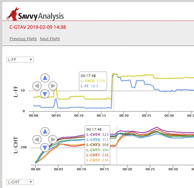

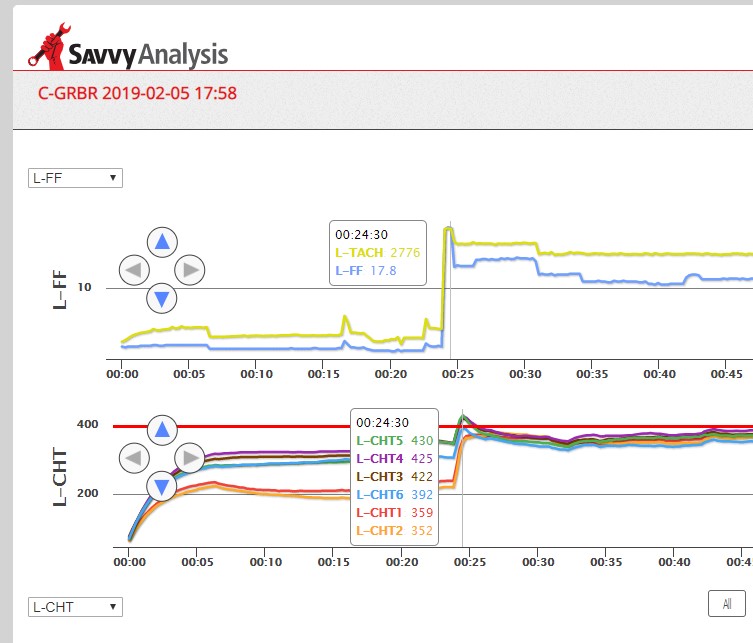

So I actually have more concerns about your front engine than your rear. The front engine on a Skymaster has better packaging (the cowl is tighter but better designed) from an airflow point of view but your front engine is running hotter than your rear.
Looking at the data I think there's one or two smoking guns and it's the fuel flows and possibly timing. I've attached two flights from this week; one yours and one mine so we have similar ambient temps, etc. The book calls for 18.1GPH takeoff fuel flows and the conventional wisdom has been to pad that a bit. Comparing the two, your front engine ranges from 17.6GPH to 17.8GPH at takeoff power and my front engine seems to stay at 18.3GPH. So the front needs more fuel.
The other thing to look at is ignition timing and the rate with which your cylinder temps rise. Your CHT's climb FAST and this can be an indication of timing that's advanced. As a matter of fact, I'm going to be checking my timing for the opposite reason; I think mine might be a degree or two retarded.
Action items:
  1. Check fuel flows as per TCM SID using calibrated gauges.
  2. Check timing using a digital angle finder, not just the analog dial with buzz box.
  3. Let's park ours sided by side, decowl and compare baffle seals.

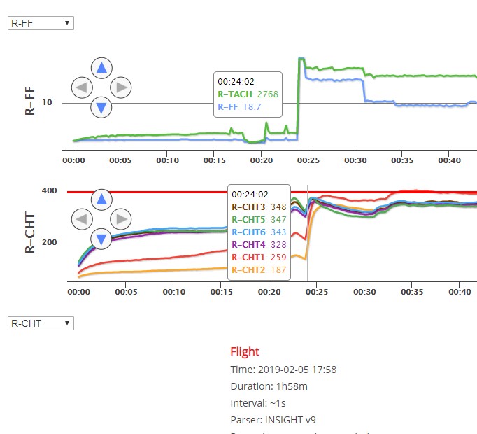

Rear engine
Originally Posted by tomcomet View Post
Up here in Canada I am flying around in 0 to -20C and even then I am breaking 400 degrees on #1 rear often and have to crack open the rear cowl flaps. Not normal and not great!
Your rear engine is a completely different story and imho it isn't an airflow issue.
The rear engine (except for cyl#1) is way happier than the front....higher fuel flow, gentler CHT rise, consistently cooler temps, etc. From what I see the #1 cylinder is an isolated issue.
Action items:
  2. Check timing using a digital angle finder, not the old buzz box.
  3. Talk to GAMI about the #1 cylinder...confirm correct injector shipped and installed in correct cylinder.
  4. Fly and record an LOP mag test. A bad plug or wire can cause high CHT's.
  5. Clean injector and confirm flow from fuel injector block.
  6. Check for vacuum leak in intake manifold to cylinder.
  7. I hate to say it but also borescope the #1 cylinder just to make sure cylinder walls and valves look ok.
  8. Let's park ours sided by side, decowl and compare baffle seals.
