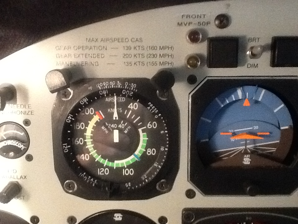

went to the hangar today...
Unread 04-14-18, 04:50 PM
JimC's Avatar
JimC JimC is offline
Join Date: Aug 2012
Location: United States
Posts: 301
Dual-scale. It's fine.
