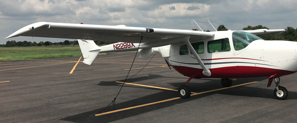

Here is a picture of a 77 337G Skymaster II with complete Horton kit installed on it. Wing tips droop plus have formed winglets on them.

The winglets are not part of the Horton STOL STC.

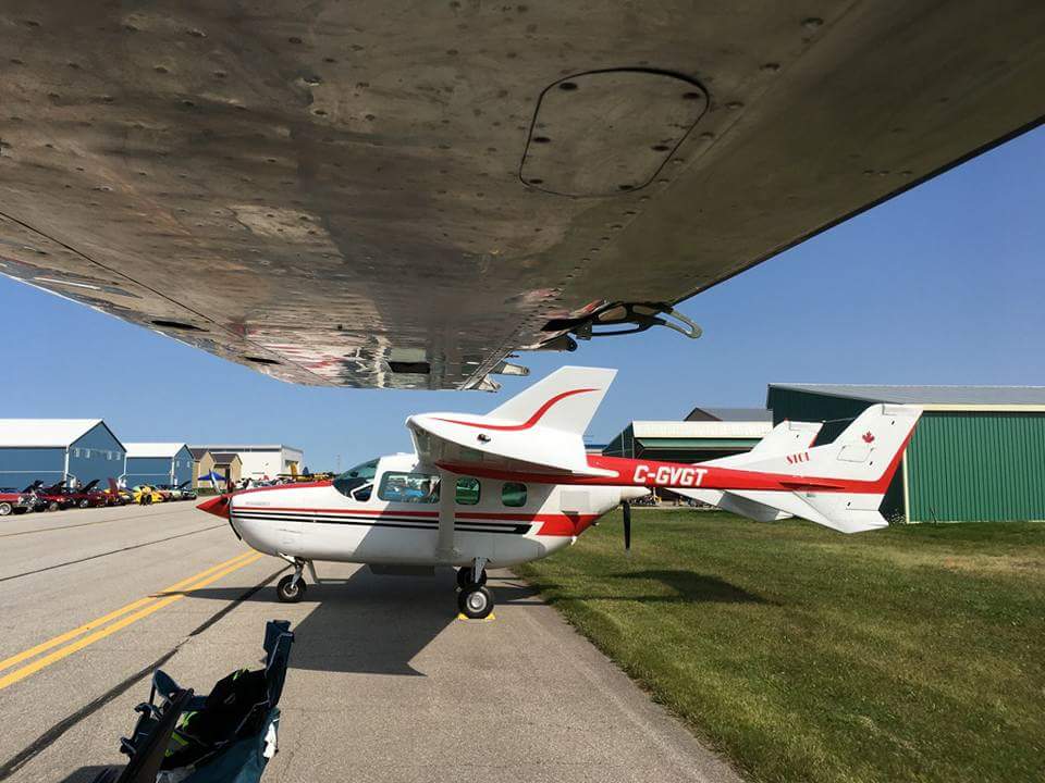

Mine has the cuff on the leading edge and a small spoiler(air gate) at each end of the wing.
You also have FENCES on the top of the wing (one on each wing) and VORTEX GENERATORS on the rear fuselage and BOOM FAIRINGS on the connection of the boom and the vertical stab
The spoilers you refer to on the end of the wing are droop wing tips. Which yours are pretty much Cessna Stock tips not the radical droop that Horton offers as an option
