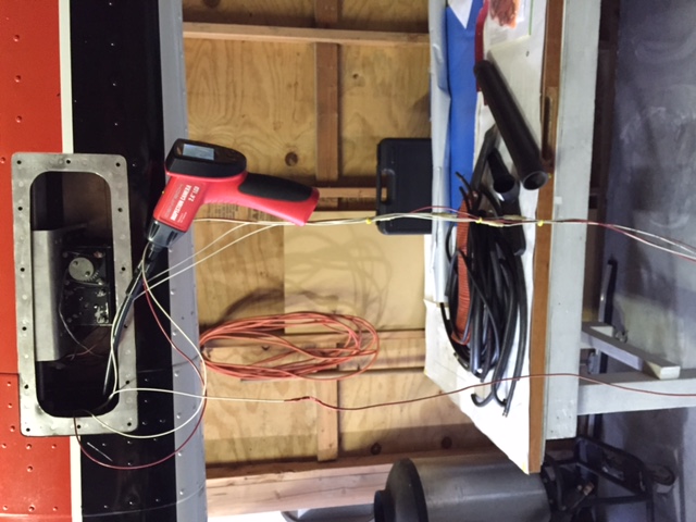

I just completed a full re-wire of the right tailboom. I replaced the harness that feeds the beacon/position/electric trim motor. The original system has multiple connectors in each line. These are simply multiple opportunities for trouble. I ended up running eight (8) wires through the boom. The breakdown is three for the position/strobe, three for the future Aveo red/white beacon, and two for the trim motor. I am doing all central point grounding. The extra with for the beacon and tail position are ground wires. When completed it makes a very nice install. It took about an hour to fish in all new wiring. I used red/yellow/black/white. These colors match the Aveo lights. I've labeled all the wires with the original Cessna code and a one or two word description with my shrink tube label maker.

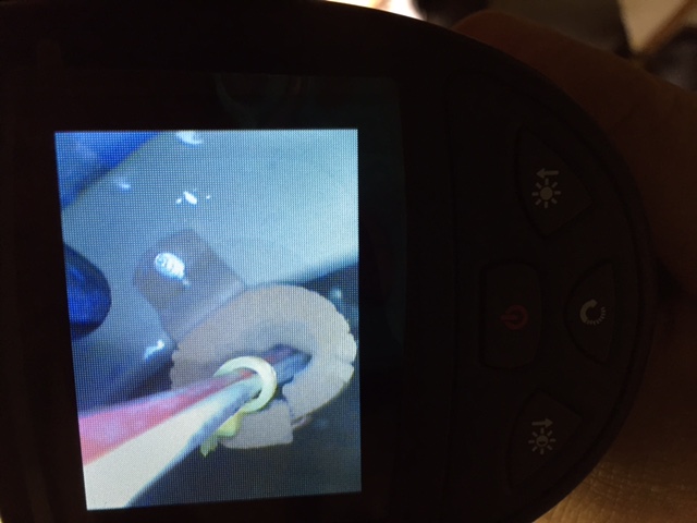

Some helpful soul put wire ties around the wires many years ago when the booms were off. The camera helped to see what was going on.
