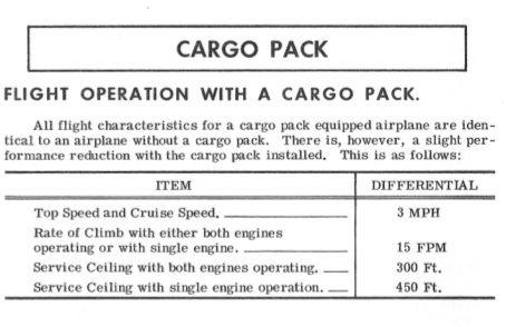

Hi fellas! slight re-vector on the thread: searched the whole internet, this and the UK forum, but didn't find an answer: anyone know the engine-out performance degradation with the underbelly cargo pod installed? I'm looking at buying skymaster (there goes the kids' college education $$, which they don't need because the only people making money these days are plumbers and mechanics!). Anyway, I'm fairly comfortable with the SE performance numbers, but can't find the cargo pod penalty. Since I'll be flying out of high pressure alt locations in the mountain west, I'd like to know how bad the SE performance is with the pod installed. Thanks in advance for your knowledge.

Cargo Pod Flight Operations
Here are the recommendations from my POH 1968 C model. Hope that helps.

Posts: 293
Thank you! That is EXACTLY what I was looking for...
