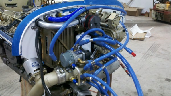

I can do your teflon hoses in various colors
all with tso and certs
Colors:
Marron
Brown
Med Blue
all with s/s fittings
I will be doing a black firesleeve next ( slip ) on type with teflon hoses underneth for a stc holder that requires black hoses with hose black baffles and seals
P.S. I also ave all the original patterns for the 336-337-P337 and Riley Rocket 337 baffle seals.
baffle seal colors :
Champion red ( Riley)
Med Blue
Black
Dark Blue
Scat orange
regards Guy Ginbey
Gee-Bee
