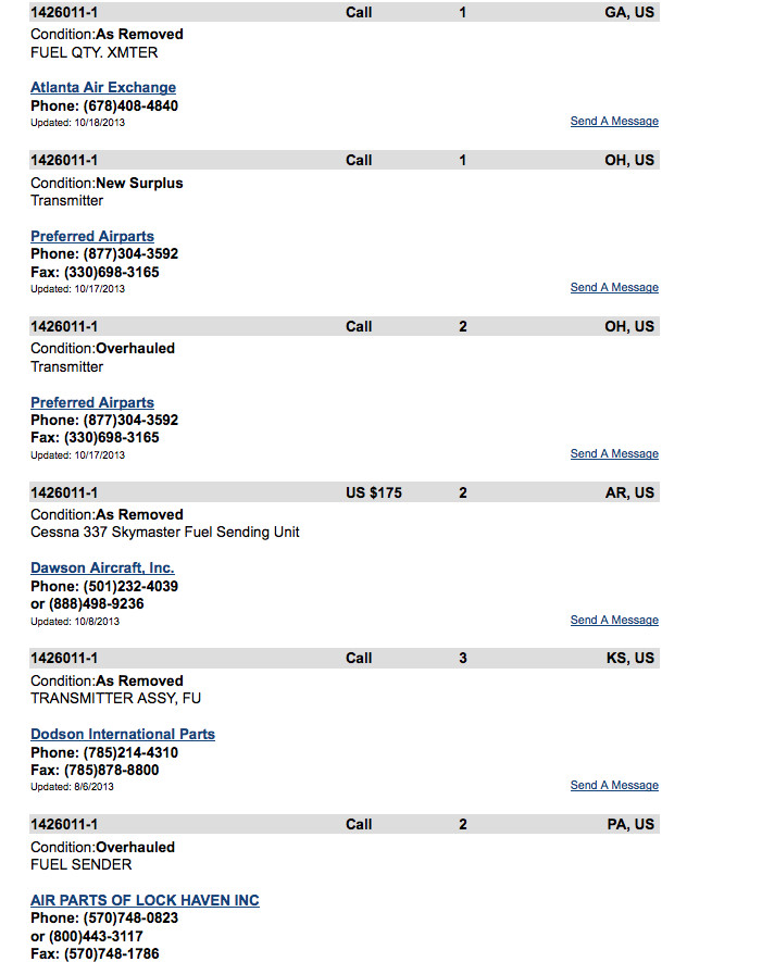

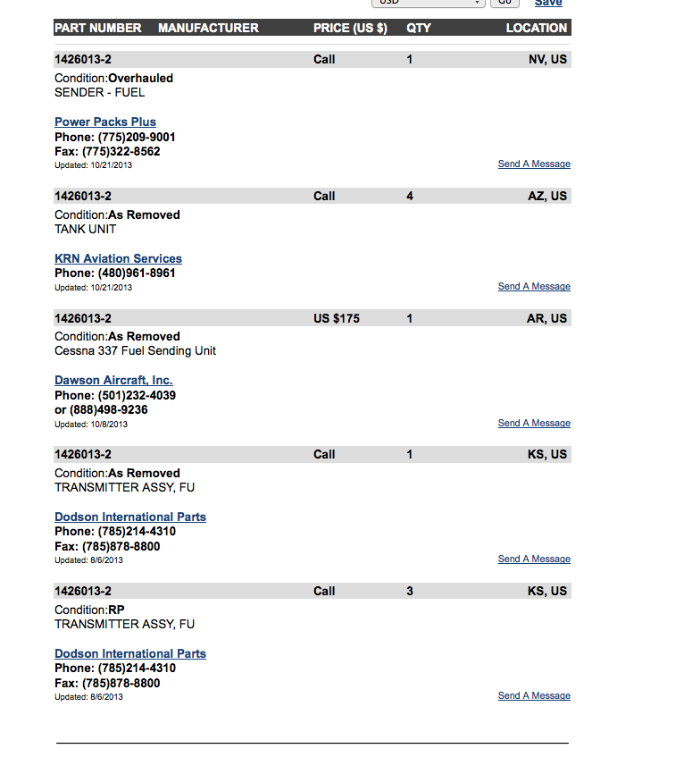

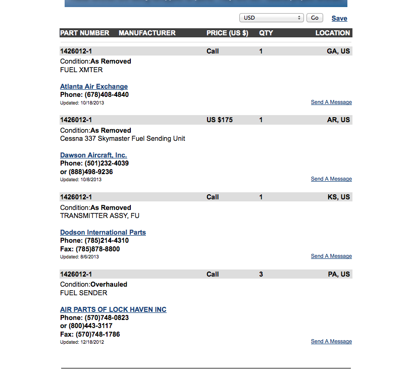

1426013-2 for aux
2ea 1426012-1 and 2ea 1426011-1 this is the part #
Unread 10-23-13, 02:40 PM
Posts: 2,286
This is parts search from Controller
see attached photos
Yingling - Cessna Parts Direct - http://www.cessnadirect.com/7740-00438.html
1426012-1 is now part #7740-00438
