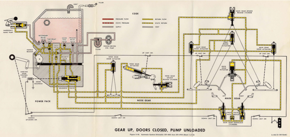

Old 07-14-12, 08:59 PM
Posts: 2,284
Bill
The main gear door actuators are held closed with hydraulic pressure. See attached diagram. If only one door coming down it lends that the system is losing pressure. It could be the door actuator on the subject door. There are no uplocks on the doors as I was reading the print incorrectly.
The main gear actuators are tee connected in with the strut door actuators. Of course there is micro switches that have to be satisfied. Sounds like an actuator on the main door is leaking down.

Old 07-15-12, 12:39 AM
Posts: 513
The way I see the diagram is, the main gear door pressure is trapped between the two actuators. This effectively hydraulic-locks the doors in place. So, my guess is there's an internal leak in one of your gear door actuators. Very easy to overhaul...mostly new o-rings, and of course a proprietary Cessna teflon "back-up seal" that will cost almost as much as socialized health care. The other possibility is the door solenoid in the power pack.
