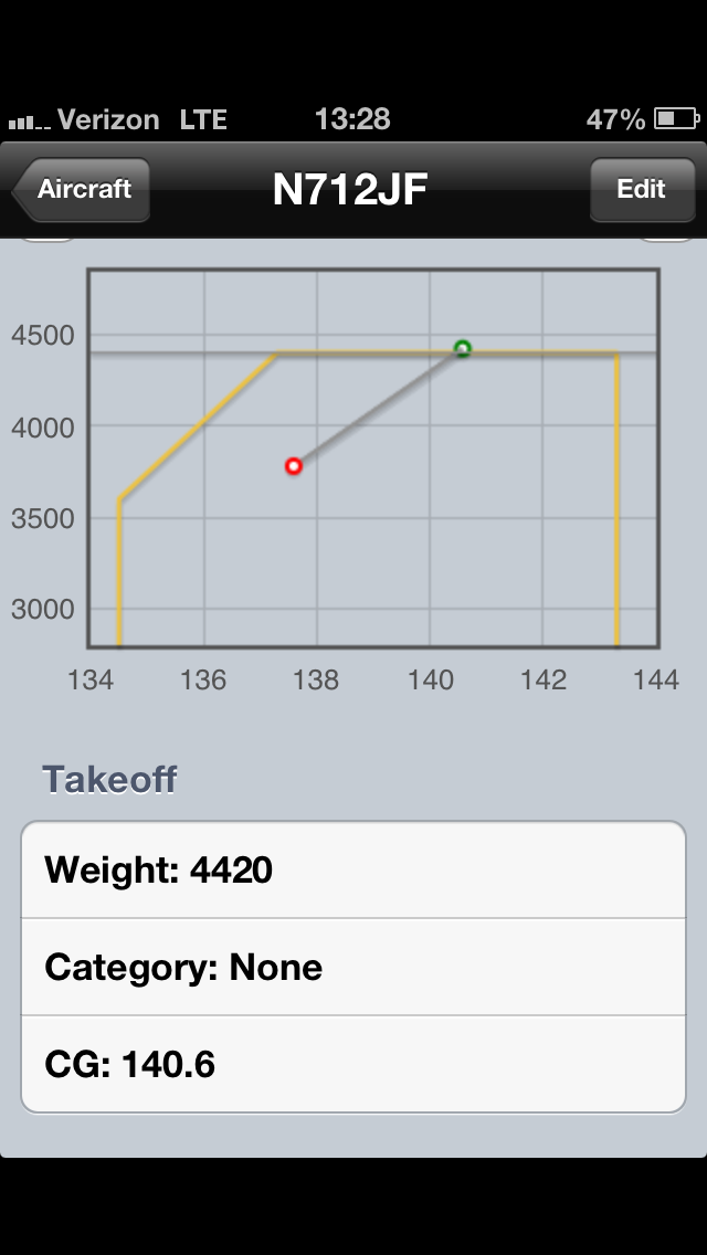

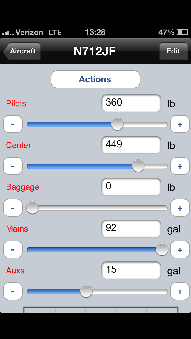

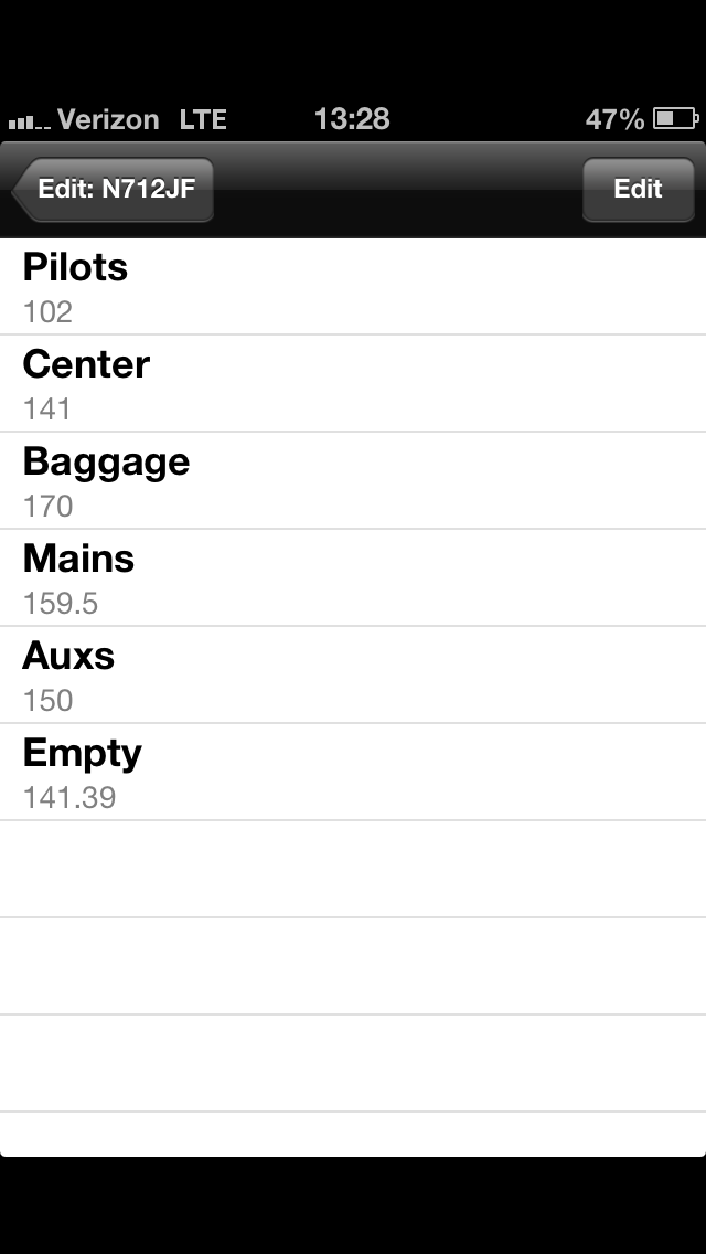

Weight and Balance Pro is really easy to use. It makes it so there is no excuse in knowing your W/B. Not sure if it is on Android or not but for the Apple products it's sweet.
Photos
1. Cover
2. Work Page for Skymaster
3. Envelope and gross
4. Building the stations
5. Building the envelope

They only offer some common templates, like 172, PA 28, so as I posted photo 4 and 5 show the work page to make the Skymaster template. It's not a problem, any aircraft can be used.
