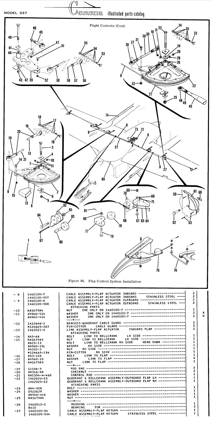

I see only 3 part numbers in the 1965 IPC figure and parts table (relevant parts shown below). Note that in the table the penultimate column is "units per assy" and it shows 2 inboard actuator cables (item 8), 2 outboard actuator cables (item 9) and one return cable (item 27). This is confusing to me, because I interpret "assy" to mean wing and I only see one of each actuator cable per wing. And if "assy" means "aircraft", I'm still confused because it looks as if each wing has its own return cable, so 2 should be listed per aircraft (not one), unless the return cable is super-long and reaches out to both wings. Anyhow, if you're working in this area, the number of cables should be evident.

Thanks Ernie. Here is a real basic question...looking at this parts sheet, seems like there were two choices (?) either standard cables which I presume are regular steel or stainless steel. I wonder, is stainless stronger in straight tensile strength...just my assumption...but maybe more brittle and likely to fail in the application here of an extreme bend. If my basic metallurgic assumptions are right, would regular steel maybe be better choice than stainless in this application? Anyone know what would drive the choice between whether to use the stainless versus regular steel -- why are both in the parts manual choices?
  #38
Unread 05-14-12, 02:19 PM
Based on discussions on this forum, I believe the consensus is to go with stainless. I believe that the principal cause of failures is corrosion. In later models, although the IPC still shows both regular and stainless, I think the factory installed stainless and there has been either no failures or far fewer failures than with regular cables. But this is my recollection and I could be wrong. Hopefully others will jump in here and elaborate.

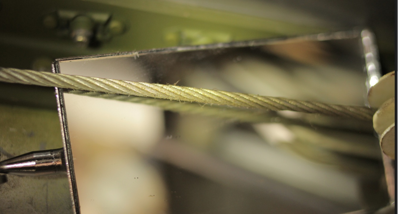

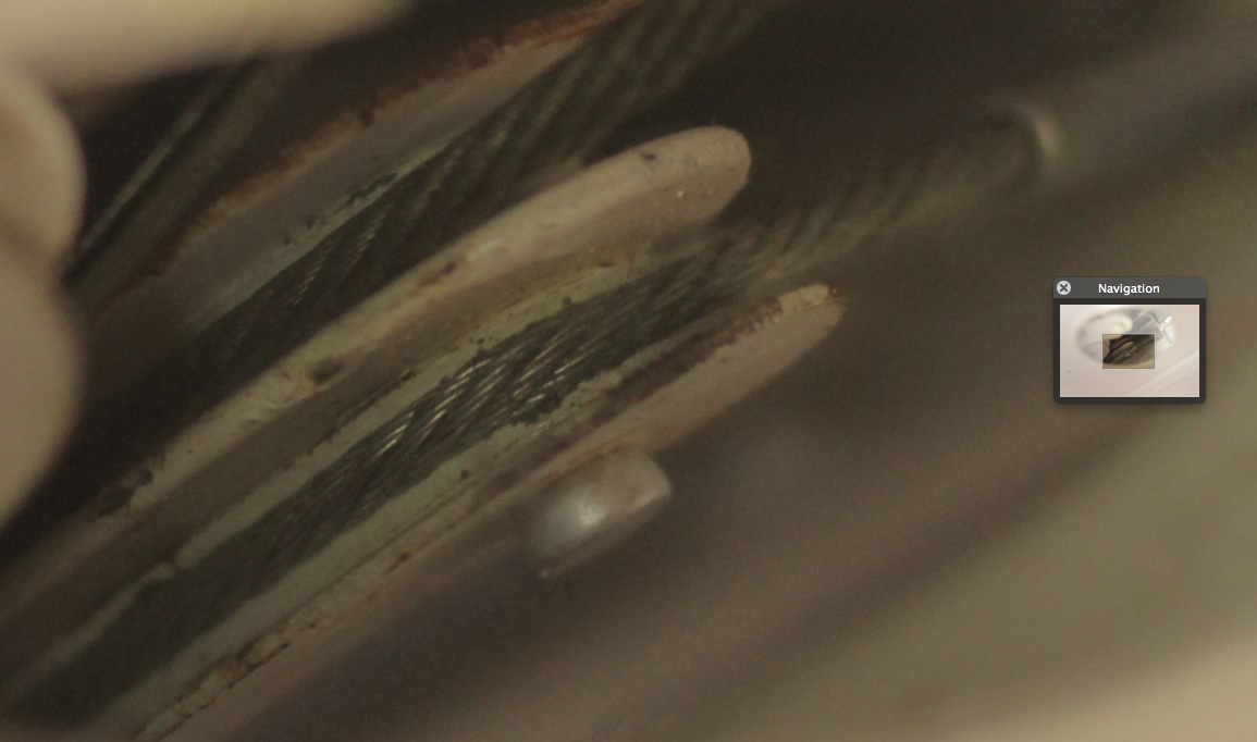

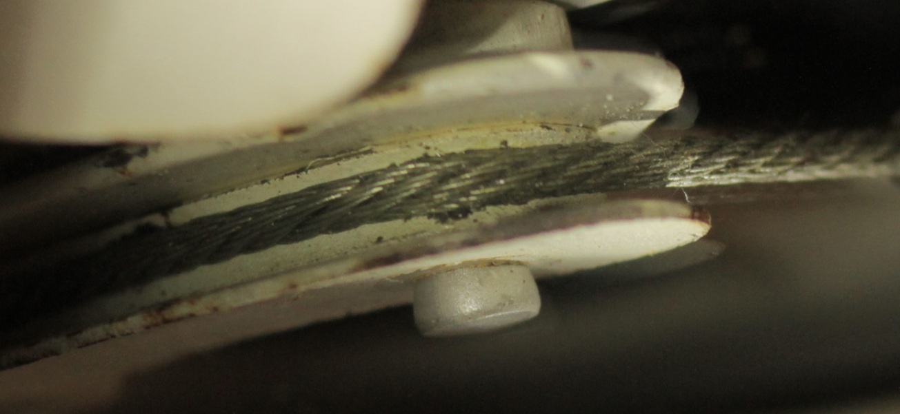

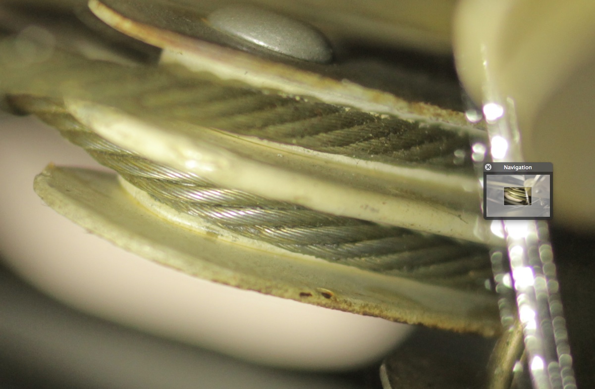

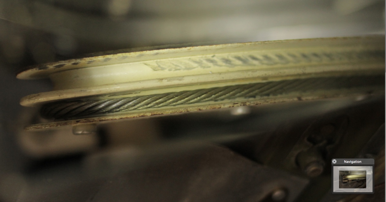

While doing the inspection on the flap cables the idea came up to photograph the cable and then take the opportunity to zoom in on the photo for a closer detailed look. Anyone have any thoughts on this method?
I am having a very difficult time trying to find a visible issue that indicates the cables are compromised. I understand that it is difficult to detect the possible broken strand without removing the cable. I question if once the cable is removed and inspected could the strands break while inspecting? With the cable in such a tight bend for so many years does the opposite bending for inspection break the strands?
Did the known failures of these flap cables give any indication of problems before they failed? Was the maintenance documented and were the cables inspected to the degree that these photos reveal? Do the cable just fail or is there visible compromising of the material before it happens?
