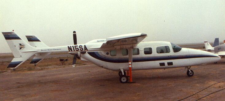

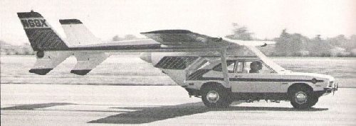

Unread 05-12-11, 06:11 PM
You missed a few
There was the Spectrum SA-550, done by Basler.
There was the Conroy Stolifter.
Both of these were turbo prop conversions.
And, of course the Mizar.
