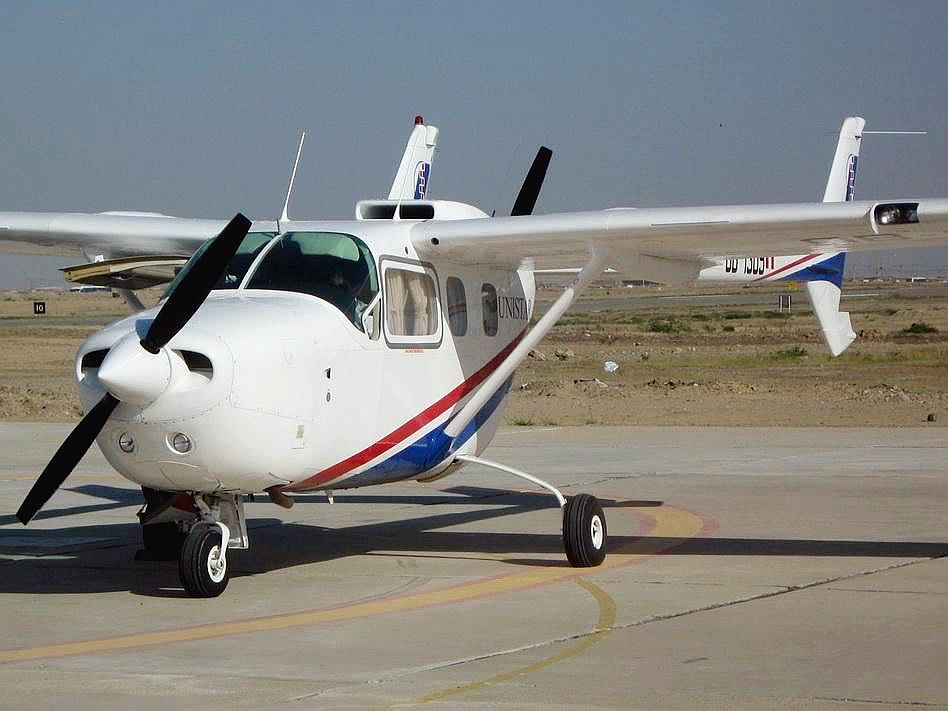

Unread 12-01-10, 07:58 PM
Right
I found this ad on Controller.com, and it shows a late model Skymaster with 6 seats. It also clearly shows the exit window, like the earlier 337's
Here's a link
http://www.controller.com/listingsde...37/1181773.htm
ID:	1170   Click image for larger version
