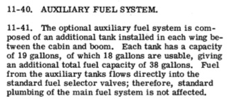

In the C336 Service Manual it states that the auxiliary fuel tanks capacity is 19 gallons of which 18 gallons are usable. See the first attachment.

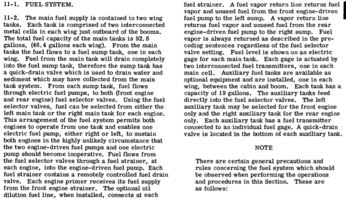

The main tank system (two interconnected tanks) have a capacity of 46.4 gallons each. If the C336 has 128 usable fuel then this would allow the mains to have 46 gallons usable each. Leaving 0.8 gallons unusable. See second attachment

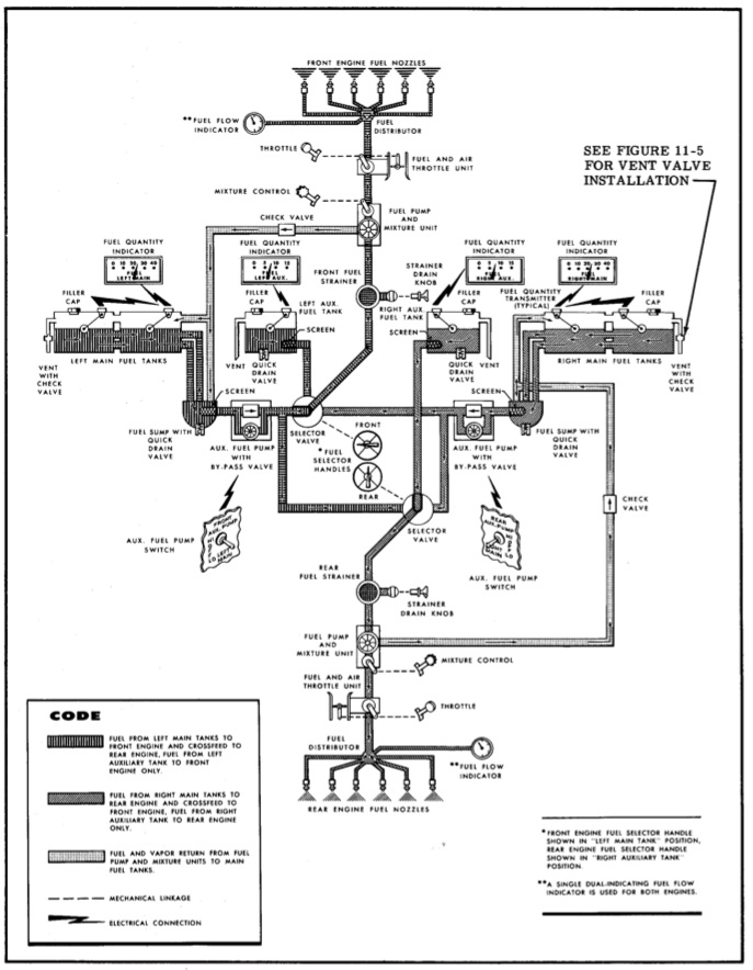

Third attachment is the C336 fuel schematic.
The main tanks have an aft connection and a forward connection on the inboard main tank. The outboard main tank is interconnected to the inboard main by an upper and lower front connector and a lower aft connector. These connections are depicted on the schematic attached. Here is a photo of the tank http://www.337skymaster.com/messages...ead.php?t=2309
