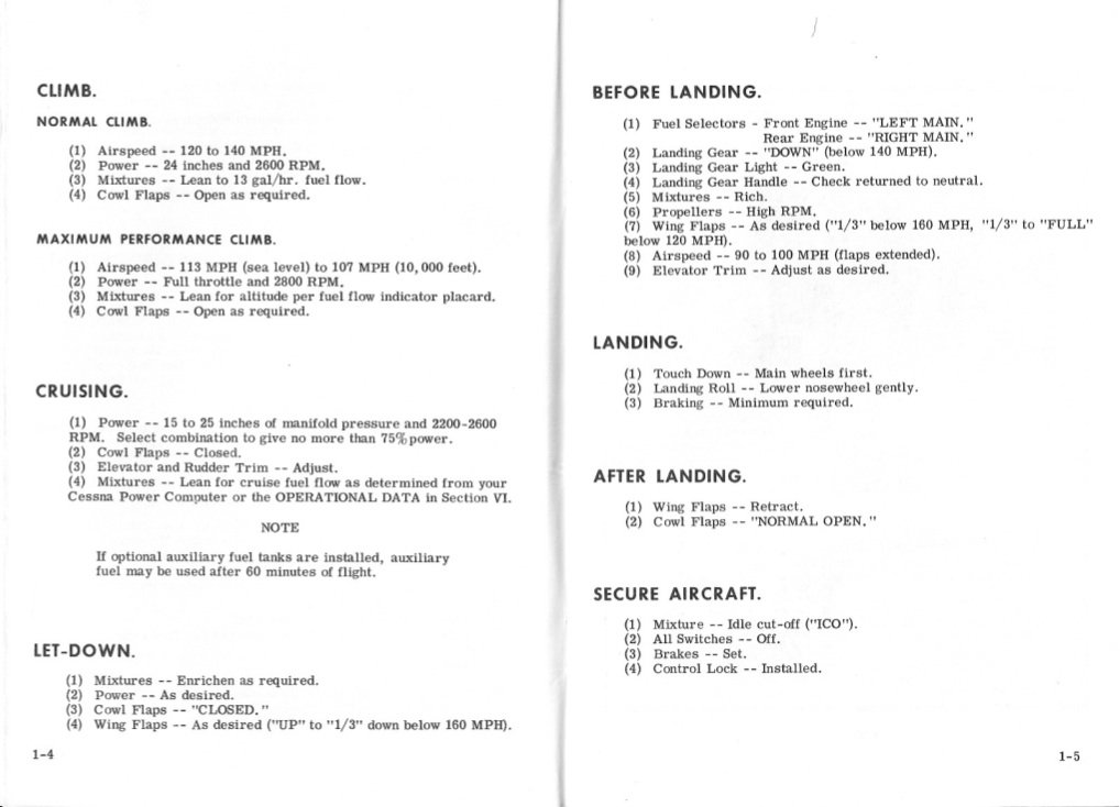

Might I just say (and please others correct me) but isn't 90mph on final with full flaps a bit fast for that much flap. I could see it over the numbers, but I've never liked full flaps and a lot of power to "force the plane" down final. It seems so much smoother to be at 1/2 - 2/3rd flaps at 90, and then just shy of the numbers hit the rest of the flap to bleed it to stall speed on touchdown. Thoughts ?

I think Ed is referring to the approach and ready to land. Not over the fence yet. I use about the same, full flaps at 1/4 mile final and 100 MPH IAS (blue line) and then let start to bleed off. I have full aft trim at this point and once I cross the fence at 85-90 MPH IAS just pull the throttle off and let it sink to the flair. Greases every time. If it is a short field then I will establish an airspeed of 80-85 MPH IAS, with power, full flaps, full aft trim and fly the airplane to the fence then bleed it off. Normally the horn is squawking before I reach the fence but with the stol wing the horn sound pre-maturely.
The POH attached calls for the 90 - 100 like Ed quotes too.
Name:	Snapshot 2010-02-15 21-45-04.jpg

I guess it depends on how you read it, and what you are comfortable with. I learned out of a grass strip years ago, with an instructor who always talked about gliding to the runway in case of engine failure. This being virtually impossible if you are powering your way down the hill with a lot of flaps. I just looked in my book and for normal landing it say: Airspeed - 80-90 KIAS (flaps UP)
2/3 to full below 110 KIAS
Airspeed 75-85 KIAS (flaps down)
Trim - Adjust
touchdown - Main first.
I always took that to mean the stabilized short approach (with full flaps) is 80 KIAS+/-. Of course it may be splitting hairs as 80 KIAS is like 90 MIAS, but it is still a might slower than Blue Line with full flaps.
I guess it is just what you get comfortable with, but regardless I try to stay away from full flaps until I am within 1/4 mile.
