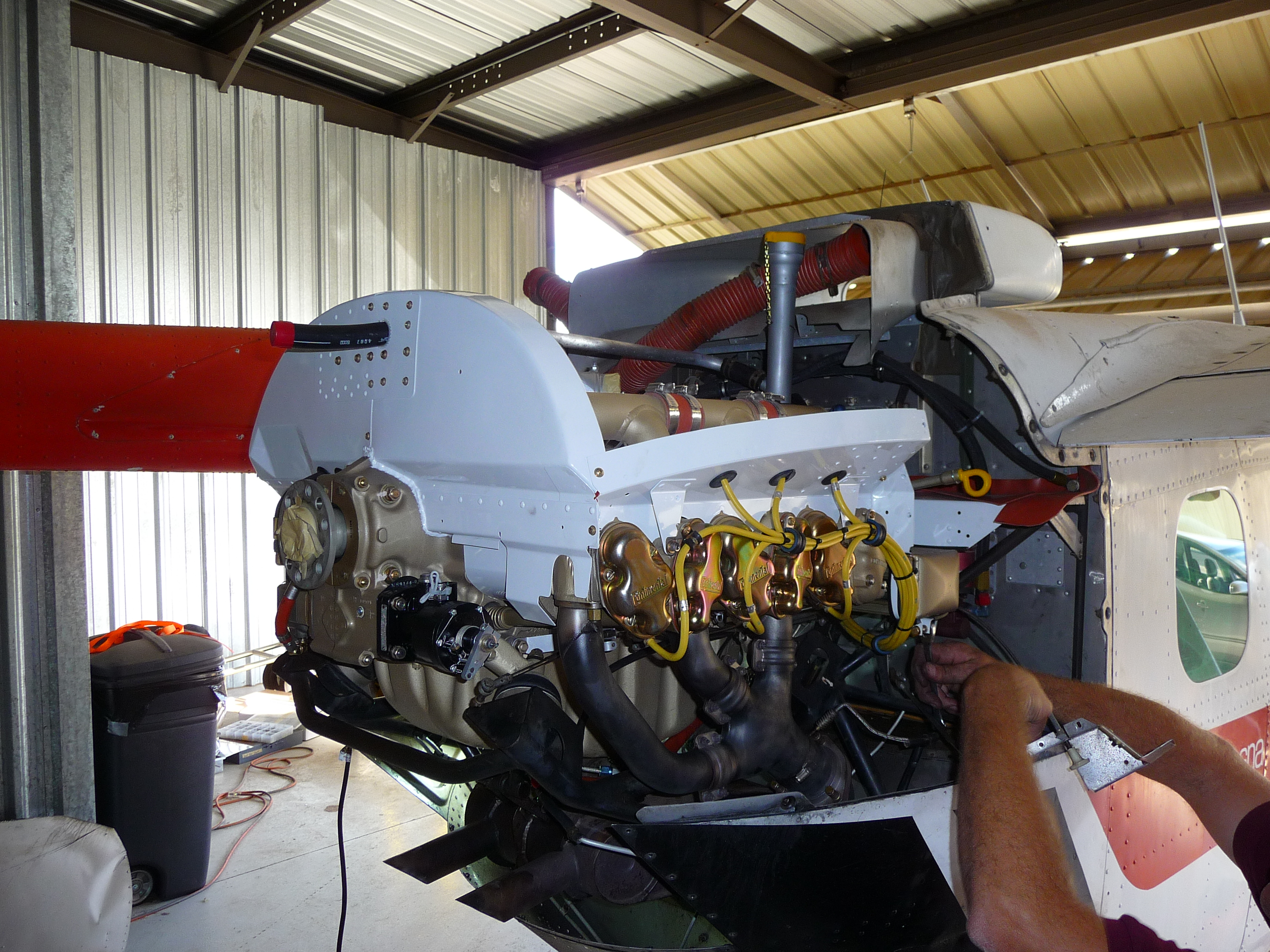

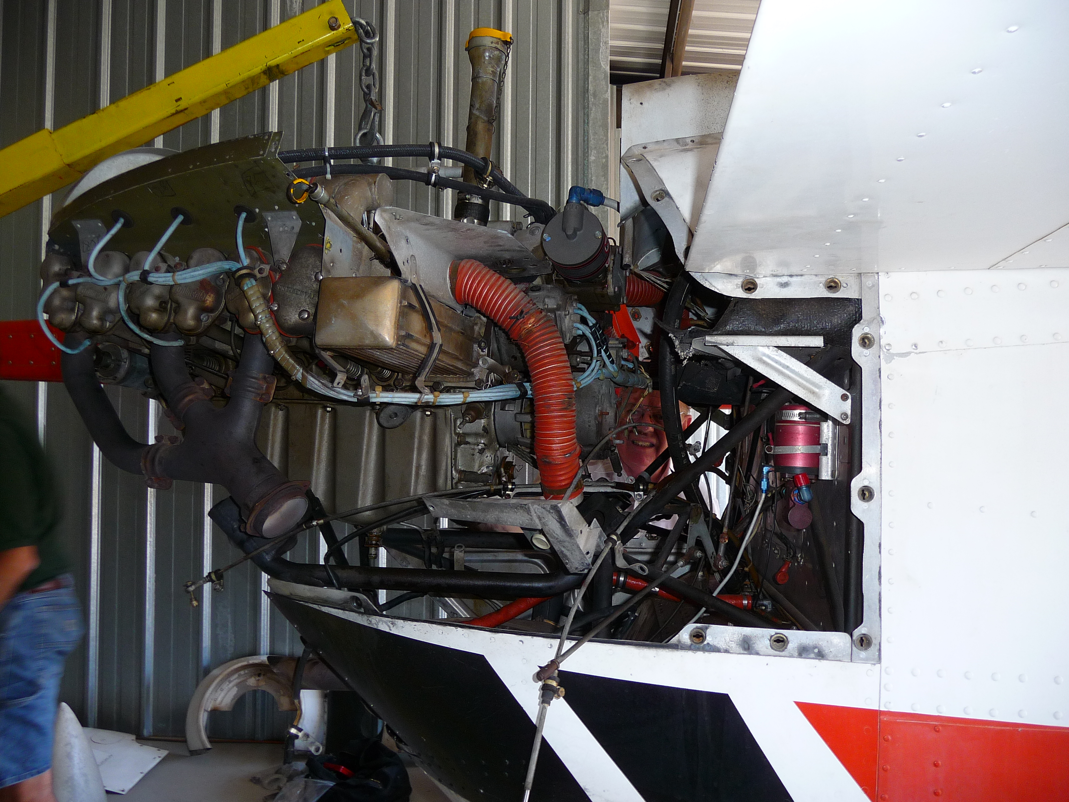

Dale, The old engine is out and the new is in (see attached pictures). Right now, the old engine (and starter) in in Greeley, Colorado at Beegles Aircraft. I'm going to be seeing the Beegles engine mechanic today. I'll talk to him about the swap and let you know. If this works out, I'm not looking to make any money off the deal, just cover the shipping and mechanic. Also consider, my old starter is about 32 years old. It is the original starter that came with the aircraft from the factory. It has spent most of it's life sitting in a hanger, and the engine only has about 800 hours, but 32 years seems like a long time for a starter. I have not had any problems with it. Todd

Jay,
The inspections that were done were visual inspections only. The mechanic that swapped the engines did visual inspections for cracks and corrosion. My 337 only has about 800 hours on it and the mechanic indicated that if the plane had high hours or had been operating or stored in a corrosive environment, he would have removed the mount and sand blasted the paint off and inspected further. If then an indication was found, he would send it out to a shop that specializes in mount repairs. He did not recommend a shop and I don't have any personal experience with one. There is an ad in Trade-a-Plane for Aerospace Welding in Minneapolis. As for the cost, this took place as part of the engine change, I don't think it took a great deal of time to do while the engine was out of the way. I hope this helps, Todd
