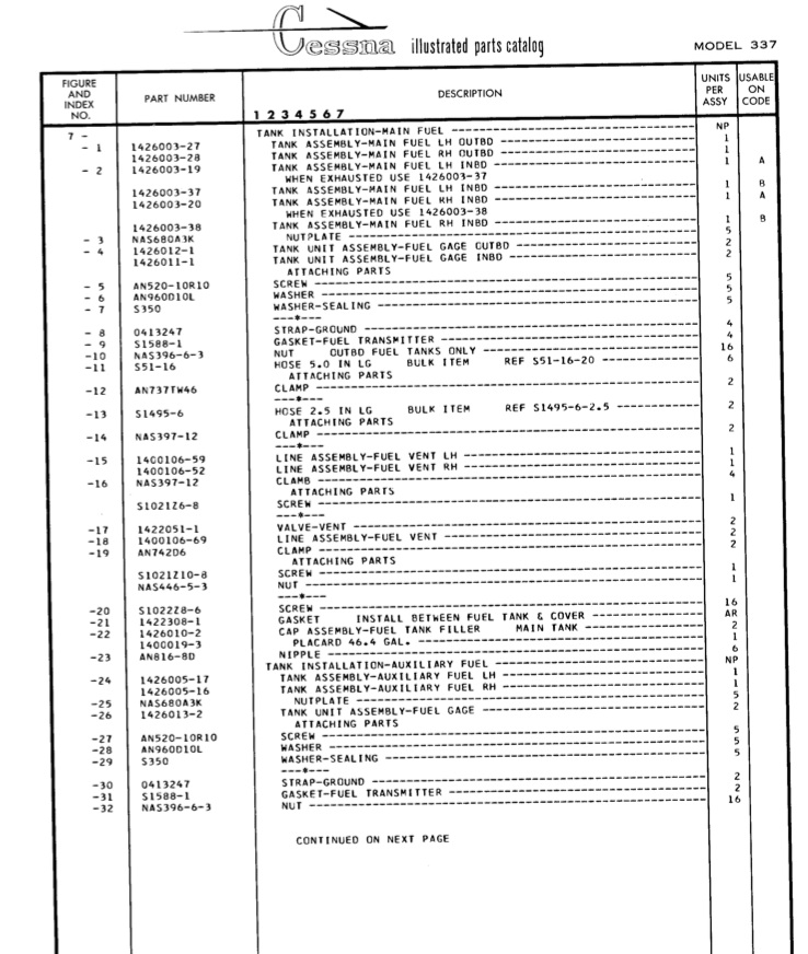

Posts: 989
I think you want an S350, which is a standard/stock aerospace part (see figure below).
