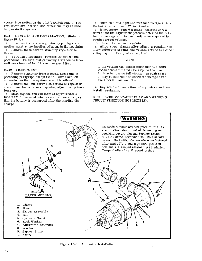

Alternator Removal/Installation
From the Skymaster Maintenance Manual.
After opening files - Click on the open image to see more clearly.

I've removed my fair share of front and rear alternators, and have never had to disconnect a fuel line or cowl torque shaft to remove the unit. A little creative twisting and turning, and the alternator will come out just fine.

I have never removed the fuel line either. I do find that moving the torque tube saves some four letter words for later use.
