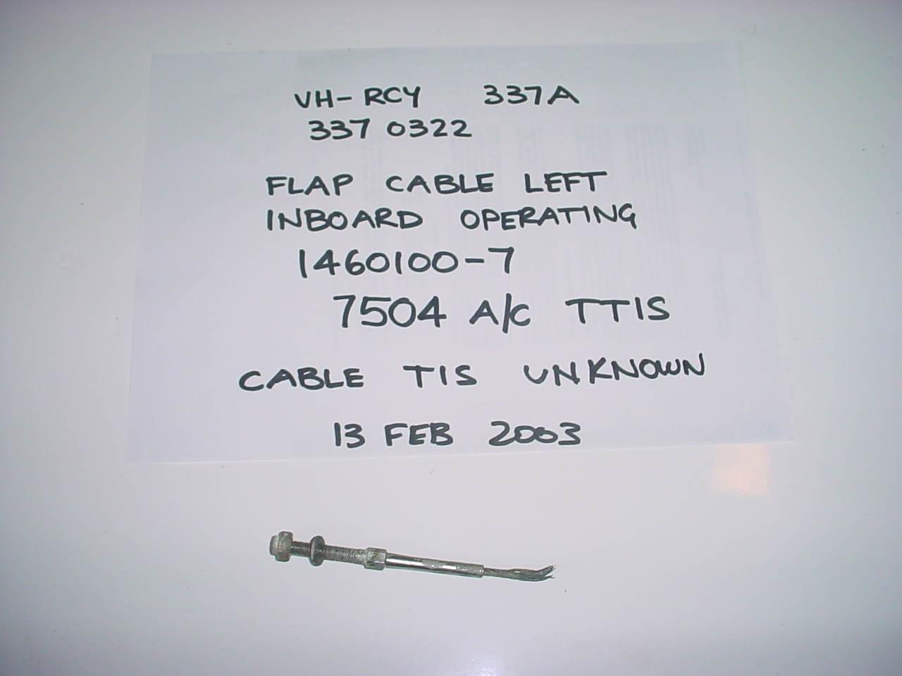

pic3
this is the broken cable. NOTE it is 1/8 (big cable)

Also, to Kevin Swash, if you have time it would be nice if you could explain why you think Fred's cable is defective from the picture... I don't have an opinion either way, I am just curious to understand yours better.
Kevin Mackenzie
Unread 02-27-03, 07:46 AM
Flap Cables
Kevin to Kevin!
Pics no problem, use them where you please.
Your comments and questions
Bad design yes I agree but it works and has for a long time.
With regard to looking at the cable in situ if it has broken strands you want to know about it. It seems that the heart strands go first and these are not able to be inspected in situ. The cable in my pic looked like Freds in the mirror. This aircraft was 8 hours out of annual by a company that looks aftere several 337's.
1/ Broken strands. Just loosen the turnbuckle and undo the nut on the ends and dont bend it 90 if you are of the opinion that the cable will suffer damage from opening it up. Wiping a tissue on the outside of the cable in situ will not reveal the wear on the inside or heart of the cable. Wipe the inside to be sure.
2/ Must be removed to inspect.
3/ Nothing lasts forever and 5000 would seem a realistic life at the moment. Lets see what the lower time airplanes look like before we fix a life.
Why do I think Freds is defective?
Well look at the cable in the same location as ours broke and you will see that the cable has unwound slightly. This I would be concerned is due to wear and broken strands against the bellcrank and or in the heart strands.
Best to be safe than sorry!
Hope this answers all your questions.
Best regards
Kev

I also got the AWB and went straight to the LAME and asked how seriously he checked the cables during last annual I think I got the "all care no responsibility answer"
So I'm trying to get a better understanding of the situation with a few questions:
1. Your example is a pretty old serial number did the design or cable part number change during production
2. Did your cable crimp ferrule show any signs of corrosion
3. Did the cable or other components show any sign of corrosion
4. Is there any wear on the cable or components that can be contributed to multiple parts abrading each other
5. Are there any other visible signs prior to removing cables
6. Do you think this failure is related to
Atmospheric corrosion
Stress corrosion
Tensile stress
Mechanical stress ie. routing, or
fatigue
I suppose what I'm asking is this related to the earlier models, high cycle, corrosion or some other factor which will help me build a picture and maybe believe what I am being told by the maintenance guys
Regards ............. Wayne

I am no way suggesting these be pulled every 100 or annual that would be over the top. Pull it once now, fix it if they are bad then go fly a few thousand hours then take a look again.
If the heart strands have workhardened to the point that the cable will break when bent 90 degrees its probably time to change it anyway.
Cables are even cheaper if you find a shop that can manufacture them rather than buying genuine. We manufacture our own to sample and they sell for around $700 Australian dollars for the set of 6. (thats approx US$420) If any one local wants a set I can make from my samples here to save downtime.
twenty hours of labour sounds a little high cables only took us about 16 hours for the six. We took the oportunity to pull the flaps, grease the rollers, remove the bellcranks and grease the bearings, grease the rod ends and remove corrosion on the bellcranks and re etch prime. Total labour was approx 38 hours.
Wayne
1/My parts book shows the same cables all the way through 337 production without change.
2 & 3/There were no signs of corrosion in the cable or ferrule.
4/ No wear due to abrading, I believe it to be internal wear in the cable due to the angle.
5/ Slight visible signs in situ but very difficult to detect.
6/ Tensile stress perhaps. But good old fatigue definatly. At 7504 hours with an average flight time of 0.7 that would be roughly 22,000 cycles of the flap cable
Call me if you want 07 3275 3210 at work or 0419 182 206.
As I mentioned to a customer yeterday his 70 model plane with 7,300 hours at approx 150 knots has covered 1,400,000 miles. These planes are not getting any younger and need TLC!!
Reagrds
KS
