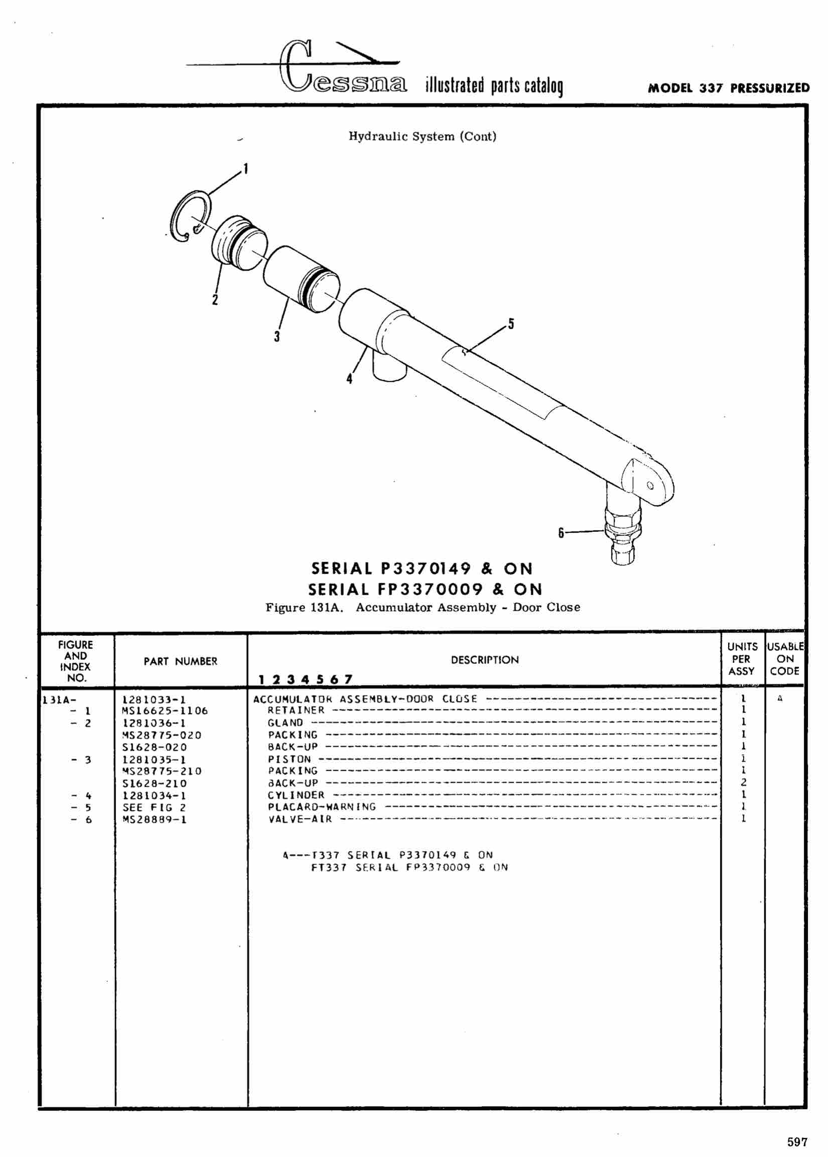

I've looked extensively through my manuals, and the best I can come up with is that p3370149 and on have an accumulator attached to the hydraulic power pack. Can't find one for the p3370067, which I own; this one is just for the records. Thanks
Unread 08-04-25, 08:29 PM
The main gear accumulator was not offered before P3370149, 0149 looks to be the first with the accumulator. This attachment is from the Parts Catalog, the Service Manual does address the accumulator but does not indicate specific aircraft
File Type: jpg Screen Shot 2025-08-04 at 5.16.29 PM.jpg (143.5 KB, 87 views)
