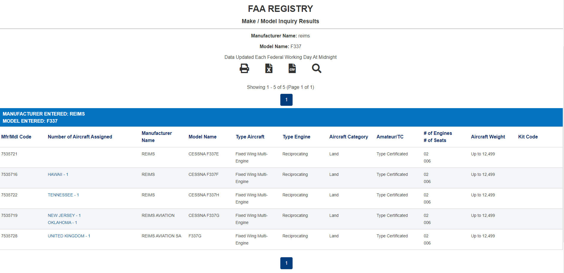

Do you have any evidence the FAA forced an owner to remove one of those engines. I would love to see it. Otherwise I find your hearsay specious. See attachment from FAA registry.
