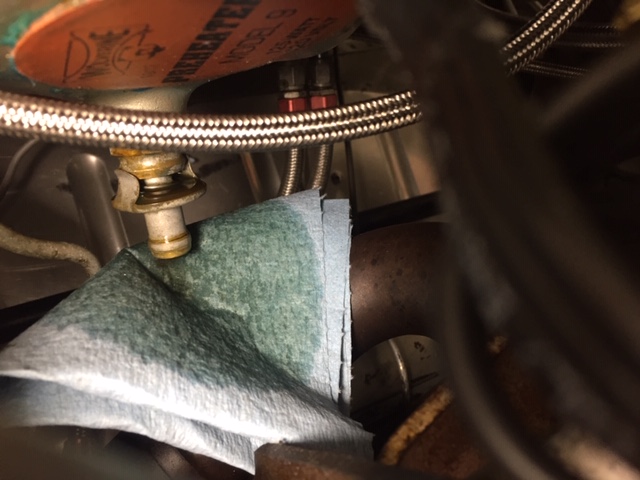

Okay, let me add one more thing. I promise this won't be wacky like the copper line mistake. We developed a small collection of oil in the center bay of the floor under the gear actuator. The oil would also drip off the left gear leg door if it was left open. I put towels under the motor for a couple of days. After two days the towel under the sump quick drain was wet. The oil was running off the sump drain and down the inside of the lower cowling into the belly.
I tried to attach a picture. Hope it works.

Picture of oil and area
Here is a picture. It's not oil, it's not 5606, it's not fuel. My mechanic's theory on the hydraulic fluid disappearing after the power back overhaul was, air bubbles were stuck in the system and as the gear was cycled the hydraulic fluid needed filling. The hydraulic level has stabilized an I have not added hydraulic fluid in quite awhile. He may be right. I don't know. I appreciate all the input. Please keep it coming.

Mystery Fluid
Based on the picture - it sure looks like engine oil...if not pin hole in pressure line, then it is breathing out of front engine or leaking like Dr. Dave's issue.
Is it sticky? I have seen old contaminated 5606 (Hydraulic fluid) take on a yellow color before...very rare but it can happen. OR - Did someone put a different fluid in your brakes?
