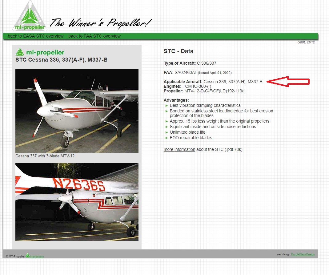

Actually it's 336's, the 337M/02 and ALL of the non-turbo/non-pressurized 337's. The PDF you linked is older copy of what's on MT's website:
https://www.mt-propeller.com/en/entw...ssna_336_1.htm

JB, not sure what you're flying now but the MT's are GREAT. I have them and love them. I think Herb has been flying them for more than a decade now.
I know there's are least one turbo bird (field approval I guess?) that's got them installed. Also, talk to Flight Resources:

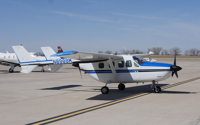

Another pressurized bird with 3 bladed MT's:
https://www.aso.com/listings/spec/Vi...1064&dealerid=
