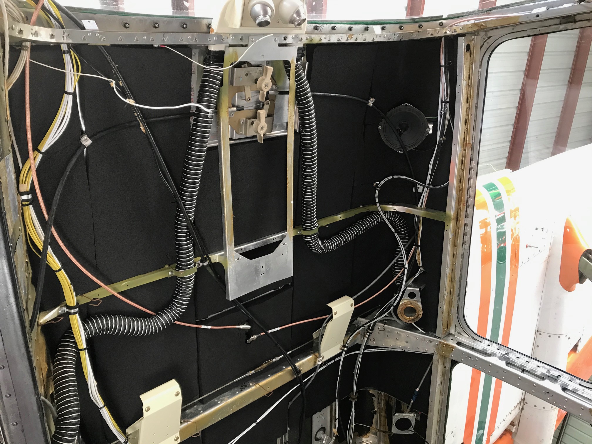

Super Sound Proofing
I purchased different thickness of Super Sound Proofing from Aircraft Spruce. I used mostly 3/4" thick, and cut to fit into all the spaces. I would put a bit of contact cement on the backs to hold them in place to keep them from vibrating out. Easy to remove if you have to do any inspection (but the way it installs on the skin panels, you can still inspect all primary structure, wiring and cables), and since they are closed cell foam, won't hold moisture and cause corrosion.
I did not insulate for the cold, rather from the heat since I live in Texas. Product is easy to work with (buy a cheap electric carving knife) and I really enjoyed installing it. May not be the best insulation - but provides some noise attenuation, some insulation, and is very clean looking and easy to work with.

Length of roll
I just reviewed my notes - I purchased two different thickness of Super Sound Proofing; 22' roll of 1", and 22' roll of 1/2". I did not use very much of the 1/2" - only in places that the 1" would not fit; mostly in some areas of forward
lower side panels, door, etc. Almost all of the ceiling and side walls was 1". I am not sure how much I used of the 1", but I have a lot left over!!!!! I would recommend you make a precise measurement of the total area you want to cover to determine how much you need. I did do that, but I was not exact and ended up buying way more than I needed.
A word of warning - the shipping cost on this stuff was ridiculous! I do not recall the cost of it, but I remember being so shocked that I called Aircraft Spruce about the cost of the shipping to see about a reduction, but had no luck. The stuff is light, but is bulky.
UPDATE - cost of Super Sound Proofing (per details above) $907.50. Cost of shipping $230.84.
