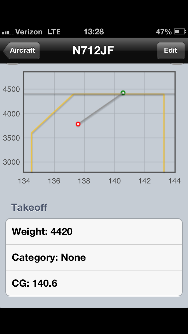

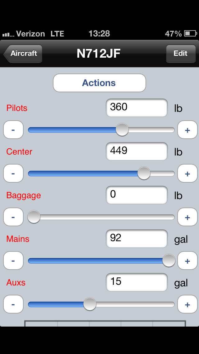

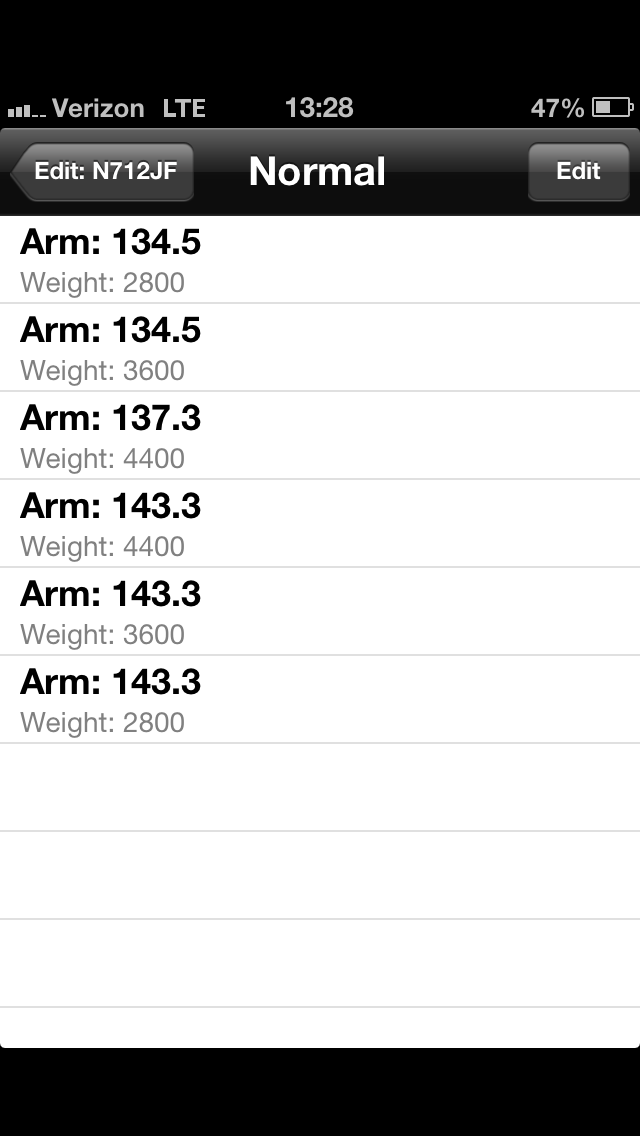

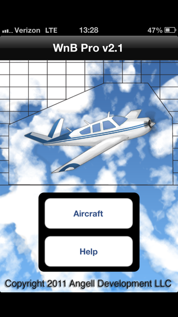

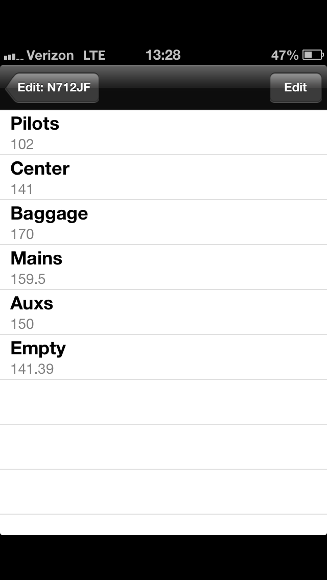

Weight and Balance Pro is really easy to use. It makes it so there is no excuse in knowing your W/B. Not sure if it is on Android or not but for the Apple products it's sweet.
Photos
1. Cover
2. Work Page for Skymaster
3. Envelope and gross
4. Building the stations
5. Building the envelope

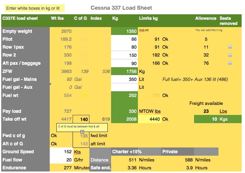

Numbers Spreadsheet
Here is a screen shot of the spreadsheet I use. The neat thing here is it's all on one iPad screen plus it has a quick fuel calculation at the bottom as one is often juggling load vs distance / fuel. You can email this page or take a "snapshot" of the page for future reference. (Press 'home' button and on/off button simultaneously to take a snapshot on an iPad). This spreadsheet is in kg lit & knots for Australia. I have a version in lbs & gal only for USA.

They only offer some common templates, like 172, PA 28, so as I posted photo 4 and 5 show the work page to make the Skymaster template. It's not a problem, any aircraft can be used.
