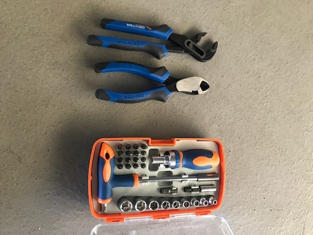

During one of the hottest days in august, just after shut down, I got stuck for almost 2h in my pressurized FT337G (build in France by Reims Aviation in 1974), because the upper clam shell door's front security lock cable broke when I pulled it !
To who it could happen, I recommend having a cruciform screw-driver (with T shape hand grip if possible) to remove the leather trim and a flat plier to unscrew the bottom part of the sleeve in which the cable slides, and finally to pull the cable (some nice people passed me those tools through the window !).

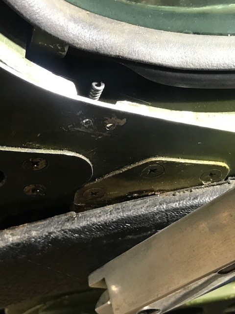

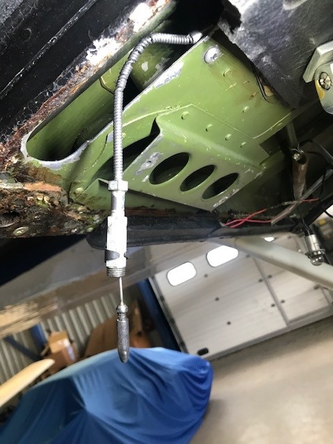

Stuck in your pressurized Skymaster ? This is how to get out !
Hi,
As promised, this is a procedure to get out a pressurized Skymaster in one of the 2 security lock pull tabs break, as it happened to me !
Some more pictures in next tread reply.
Hope it helps !

Some more pictures
Here are some more pictures !
