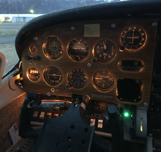

On images below, from the top down
CENTER AVIONICS STACK – 14-15 inches avail
1. Helm x650 (INC XM WEATHER)
2. KX155 ILS/NAV
3. KN62 DME
4. KY97 COM
5. AUDIO SELECTOR (original with huge blob in avionics bay)
6. GARMIN 330
7. IPAD MINI Running foreflight
LEFT
8. RYAN 9900BX Needs brain fixed flat rate $2,500 and maybe top antenna $500?)
9. WX950 STORMSCOPE
IN AVIONICS BAY
10. XM RECIEVER
11. L3 K2500 WAAS ADS In/OUT w WIFI
12. TRANSCAL ENCODER
13. AUDIO PANEL
WIRING
The TRANSCAL encoder feeds altimeter to the Garmin 330
The Garmin passes the TRANSCAL encoder altimeter to the 9900BX via ARINC 429
The original Cessna ‘audio’ panel occupies a lot of space in avionics bay. A very stale bowl of wiring spaghetti

Did images come through?
What are your thought's gentlemen (and I DO use the term loosely).
