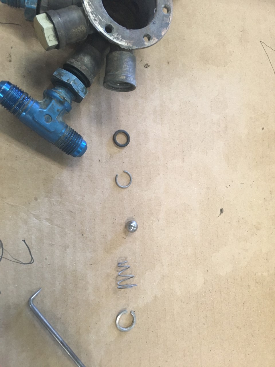

So, I am going to try and post pictures of what I did. My valves had locked up due to rust build up in the "cup" and this was making the "cam" (a cross shaped actuator that pushes the balls open to allow fuel to flow out of a portal into the main chamber, "cup") bind. I had also had a problem with one of my portals not providing positive cut-off and that was ultimately found to be deteriorated o-ring.
The inability to find a sealing gasket problem was resolved by simply tracing my original gasket on to some gasket material and cutting a duplicate and punching holes in it for the screws.
With care, the retaining rings for the springs and balls can be removed and reused and used a L-shaped pick to get the rings out. They can be "pressed" back in buy starting them by hand and using AN fitting to screw/press them all the way back down. Behind the balls, are the sealing o-rings. I measured and replaced. Be sure to use fuel resistant o-rings. The shaft of the selector also uses a fuel resistant o-ring. I cleaned this up and replaced o-ring, lubricated the shaft with aircraft grade fuel lube/grease (available aircraft spruce, etc). Reassembly was a snap. Punches were used to get the roll pins out and because autopsy valve was frozen, had to use a punch to get the selector with the cam out of the housing.
Hopefully pictures are self explanatory and this helps someone.
I ended up replacing cable linkage while I was at it and everything works better than before.
