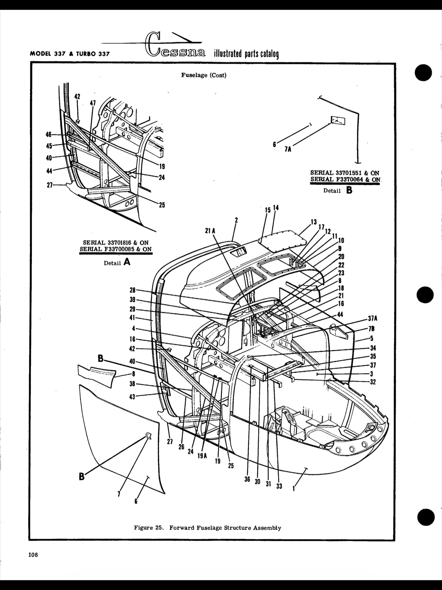

Hello All,
On the top of the engine cowl just forward of the windscreen is a panel which is held down by several cam locks which permits access to the back of the instrument panel from outside the airplane. On my 337D the panel has a gasket which keeps water from seeping inside. I've spent the last two hours looking in the IPC and not knowing what that is called, I need the name of that part or the page/illustration number in the IPC. Or if you know the part number or where to get the gasket it would be very helpful. Thank you
Unread 07-05-23, 11:27 PM
Posts: 281
These pages are from the G model IPC, but maybe it’s helpful?
Also, search the board for “avionics access”, there’s a couple threads about sealing up those access panels with RTV in the cups and weatherstripping on the panels.
