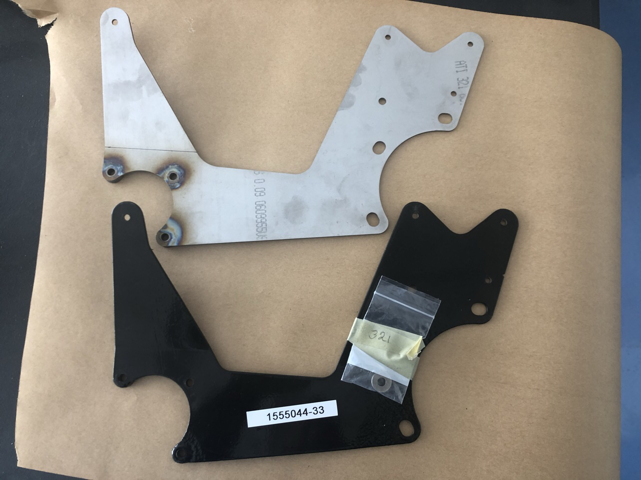

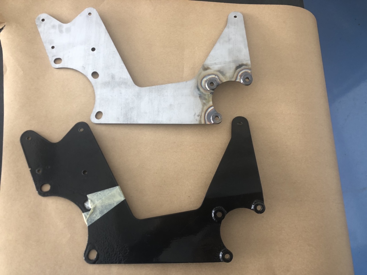

P337 Rear Turbo Bracket through s/n 200
After sand blasting and powder coating my original bracket I was not satisfied with the wear and tear the bracket has so I made 4 rear turbo brackets using my original 1555044-33 bracket. They are made out of .105 321 stainless steel. 395.00 ea for the last three.

Thanks for doing this. Will keep in mind.
Question - how many hours were on the original bracket? Can you post a pic of the wear on the original?

Supposedly 2000 hours, the pic of the black bracket is original, I know you can’t see much because it is painted now, but where the turbo attaches, very pitted and corroded on both sides, and the smallest ear for the wastegate was the same, way over the 10% rule.
The bottom support that goes from the bottom of the turbo to the wastegate was far worse, Cessna has those available, 16 now after I bought mine, there price for the bottom one is 395, a much smaller part with more bends made in a die.
