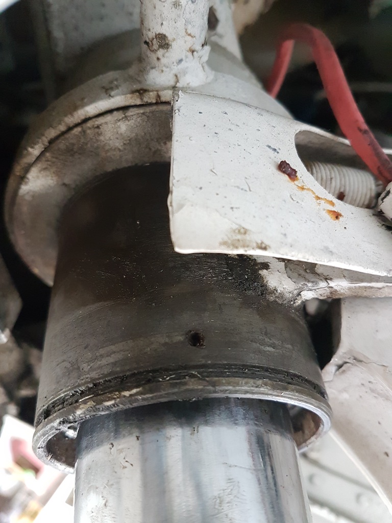

I just recently pulled mine apart to swap out all the old seals.
She now holds pressure, and works as advertised!
This thread was most definitely helpful! For those interested, I have attached a pic of the little bitty hole you're looking for. The manual just says "A small access hole is provided at the lock ring groove to facilitate removal of lock ring." On mine, it was so covered up with old grease / schmoo that I couldn't find it!
