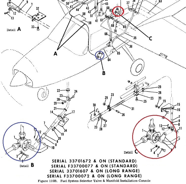

We can't turn the rear-engine fuel selector knob on my 1977 337G but we can't find the valve!
The IPC image (shown below) indicates that one is at the root of the left wing and the other one is on the fuselage just outboard of the circuit breakers. But we can't find them!
Thinking the IPC is wrong. Can anyone help.

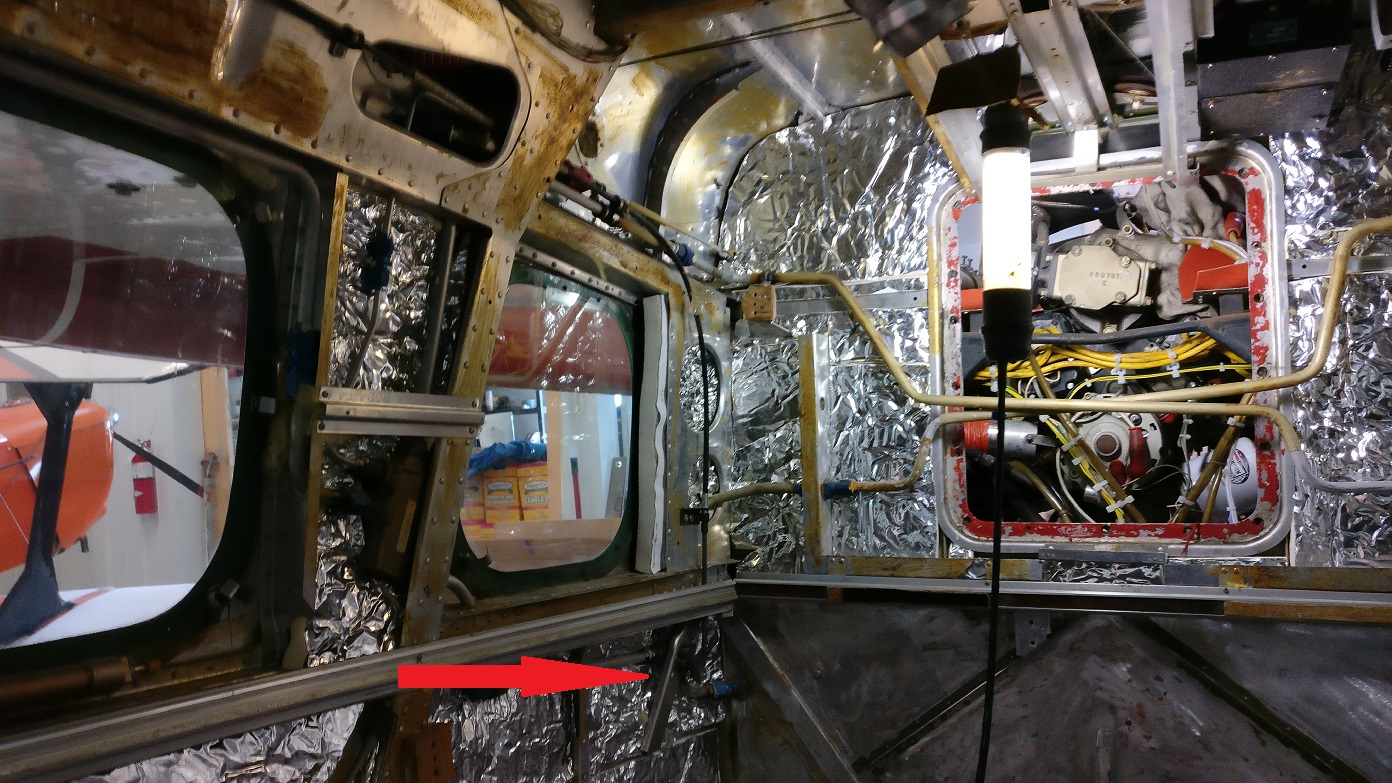

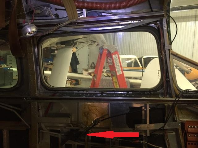

In my 1977 G model they're exactly where Kim says.
