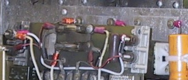

This is the assy I want to learn about
Here is a pic from another of the post streams in here. I went to the Pp link you sent so my question is about whether that R1224 assy is equivalent to that one in the pic. With the 1224 will I lose any functionality or indications or action capability in the Altn sys or cockpit? I assume that any function or action losses would have to be placarded or POH entries made?
Just trying to ask the right questions so I don’t screw anything up
Thank you.
