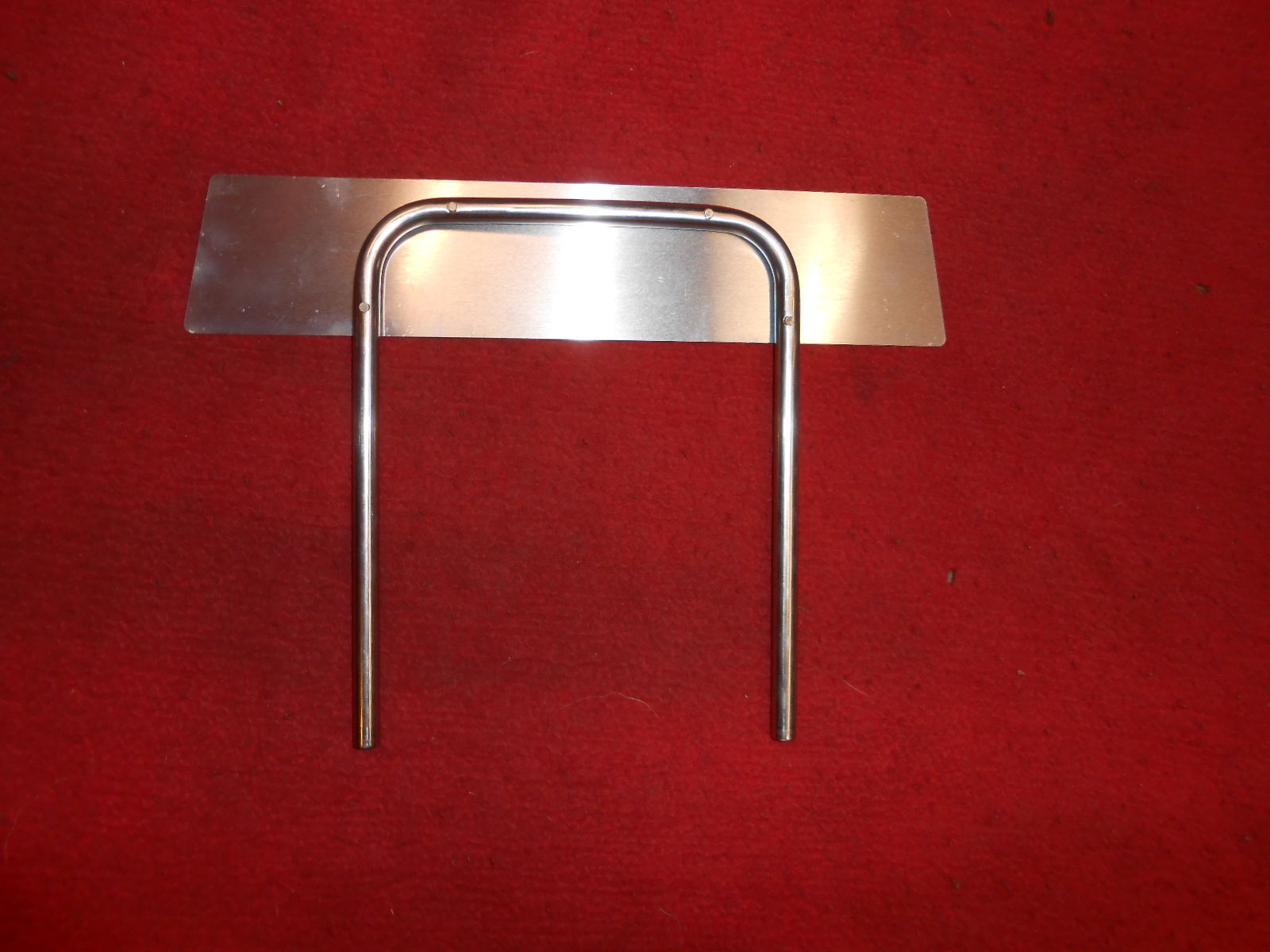

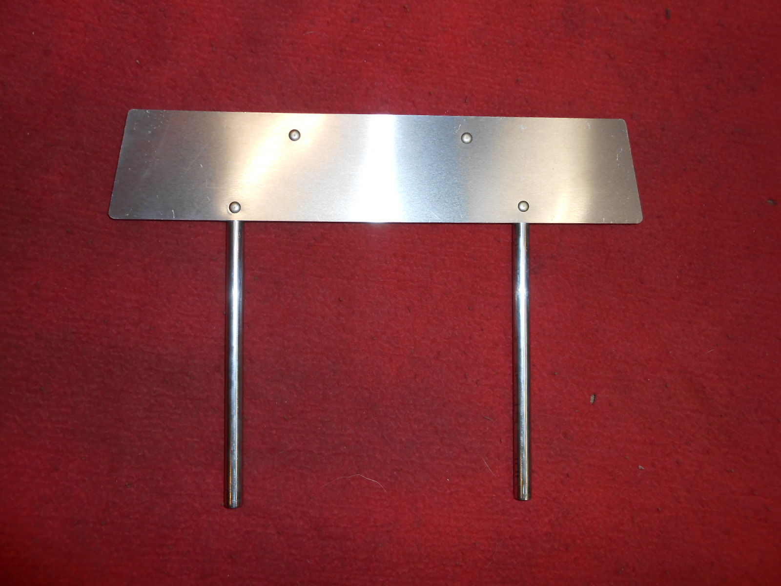

There's really not much to them....you can fab up the frames easily. The onus is on you to have FAR burn rated foam and materials sewn up by your upholstery shop.
ID:	1892   Click image for larger version
