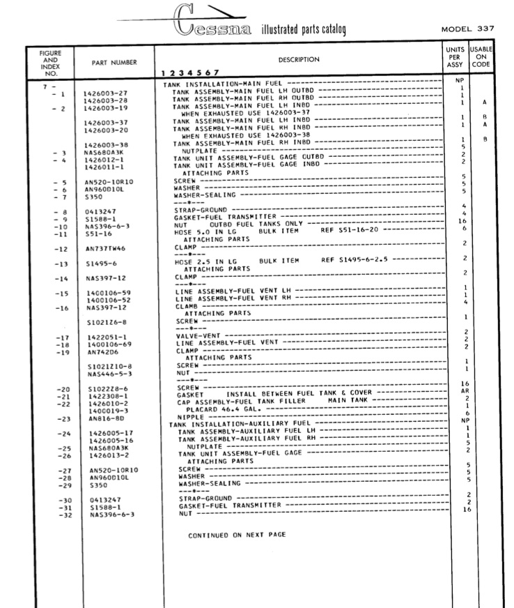

I think you want an S350, which is a standard/stock aerospace part (see figure below).

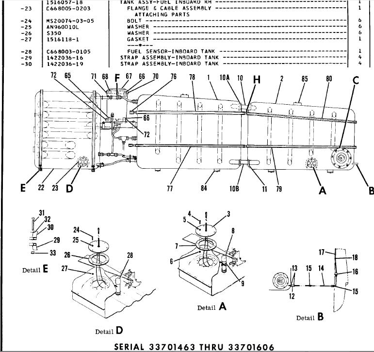

Guess it depends on the model. Here is from my PC
Part #31

Yes, Ed, it does depend on the model. Since I know yours is a '73, the picture in my message is from the parts manual for a '73.

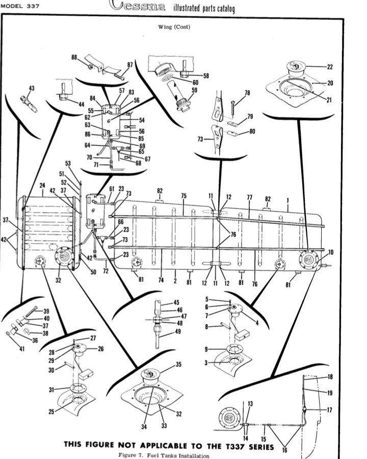

Ace of the Atmosphere
Fuel Selector Valve
So, does anyone know the part number for gasket in the fuel selector valve in the wing?
The number is listed in the O-2 Illustrated Parts Manual, it is B3-12-1. I looks like it has six screw holes plus the large hole in the center.

Unread 10-12-09, 01:32 AM
Posts: 510
Thanks, that's some good info. Why would the military get that kind of info but not the civilian? Now to find a supplier for it. The usual suppliers don't list it. Any ideas who might have them?
