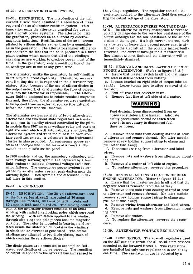

Need some help identifying a contactor on my fire wall. its not suppling power to any system and not in parts or any other documents I can find. Contactor is located on the center to Right side on firewall. Any Ideas?

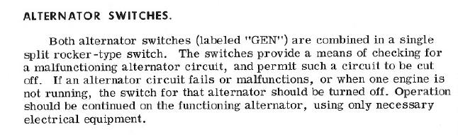

Secondly: My aircraft is a 1965 model. However it has alternators instaled. Should the Circuit Breakers be changed out to a diffrent amp rating? I think my aircraft came with generators as the CB panel is labled GEN Front and Rear.
And Last: Anyone out there changed the breakers out to the push pull type, If so what model fit in the space provided.

Your aircraft came with 30 amp alternators and the switches were labeled gen.
