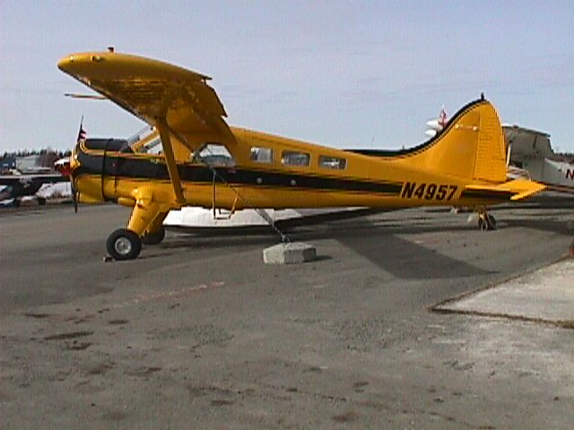

beaver
A DeHavalland Beaver.
Big thick wings, radial engine and profile of a steam engine.
need a picture ?
Bob

Oh that kind of beaver!
It even makes a Aztec look streamlined!
