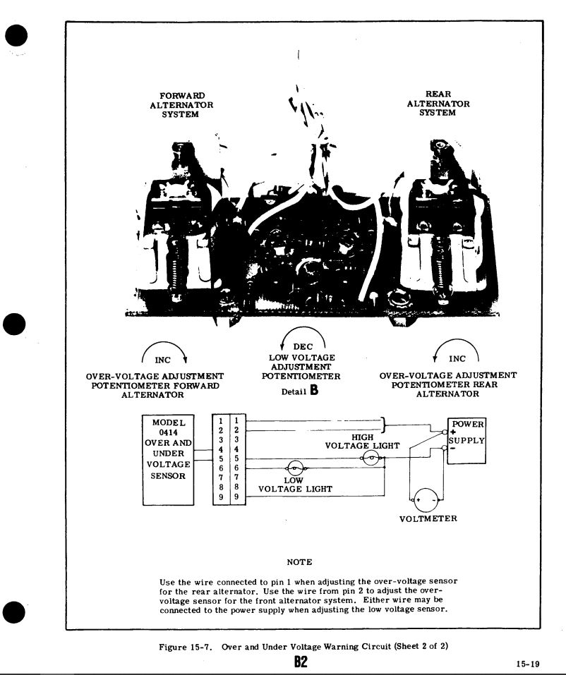

Edit: The exact voltage at which the over voltage light comes on is fully adjustable. Have you verified that it is set at the correct voltage?

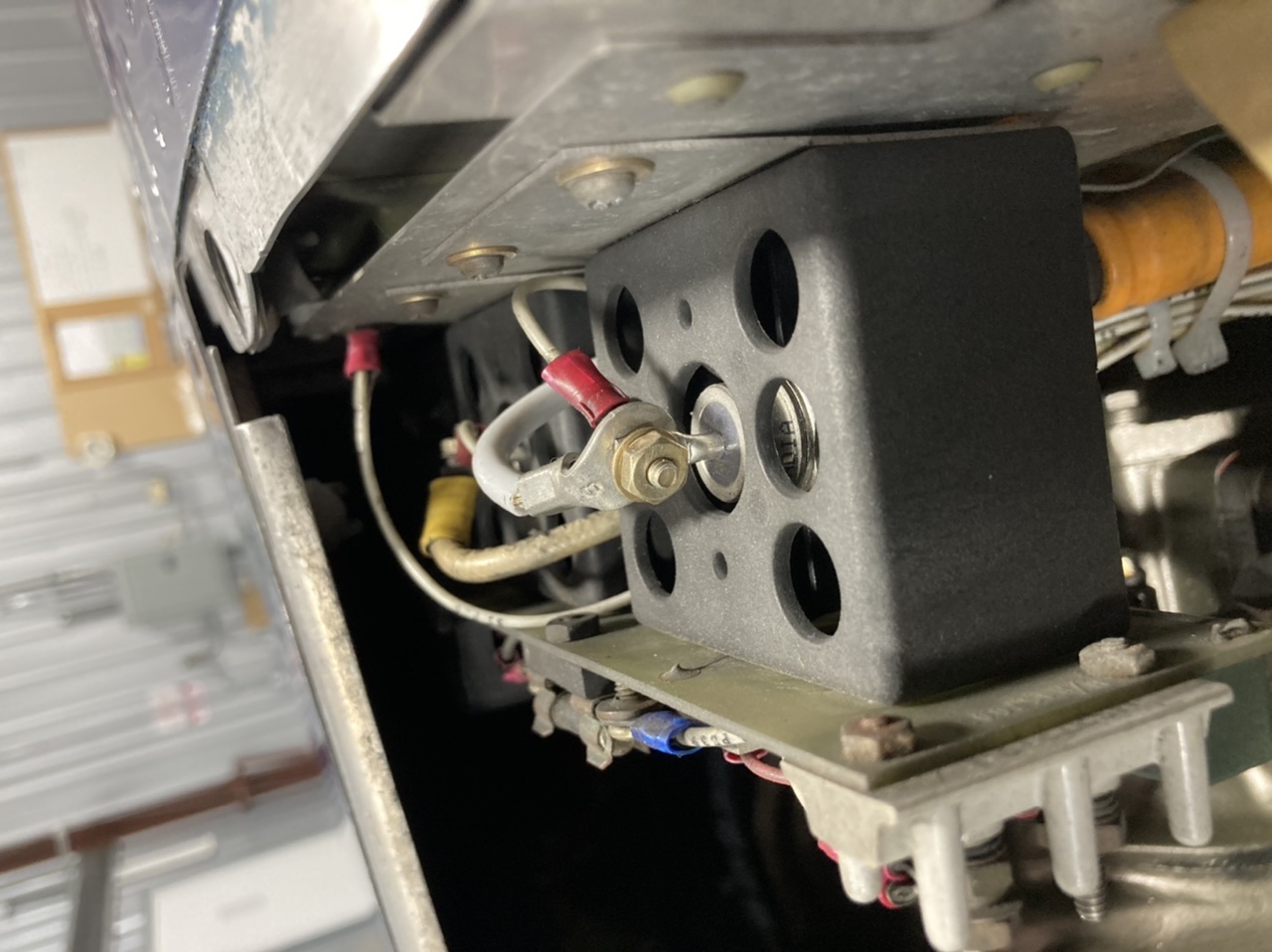

1973 337G…. Has had 3 separate over voltage issues.
See my detailed post on circuit breaker panel.
The second was a landing gear related.

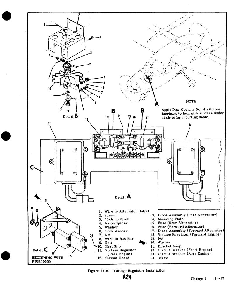

The third was replacing these 2 diodes on front firewall. One had a physical break on the post. Once this was fixed…, I’m 99.9% over-voltage free.
I had the same symptoms as you. No problem running only on rear. Running on just front or both alternators, problem present.
The diode for the front had the broken post.
Hopefully the photo attaches to this post.

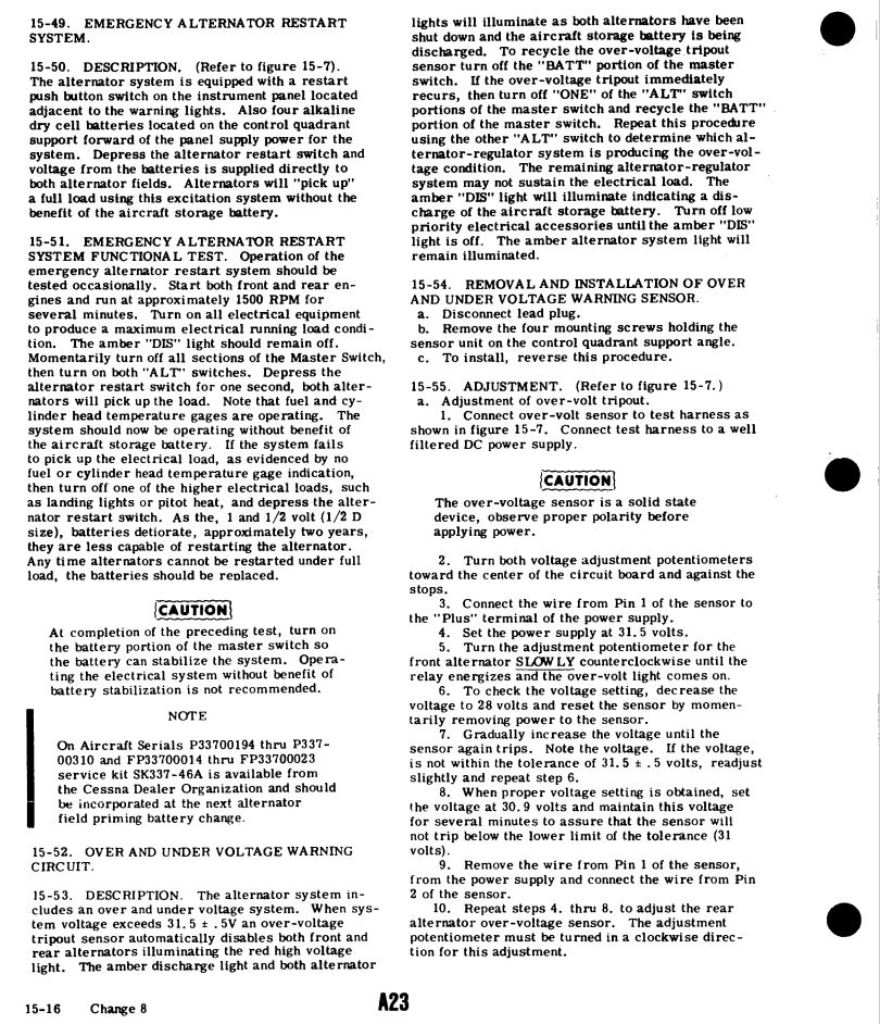

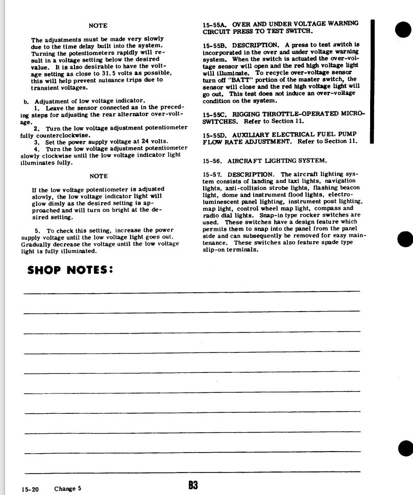

The voltage regulators in my aircraft are the solid state type and I thought they were not adjustable. how do i set the voltage that triggers the overvolt shutdown please.
i will inspect the diodes as soon as.

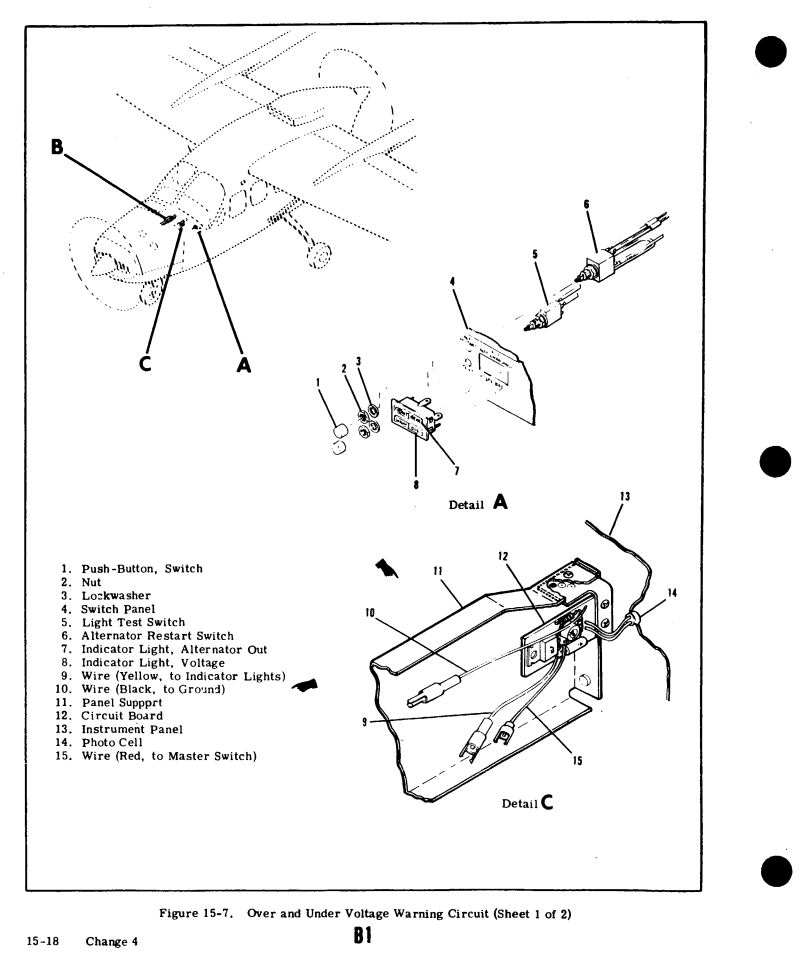

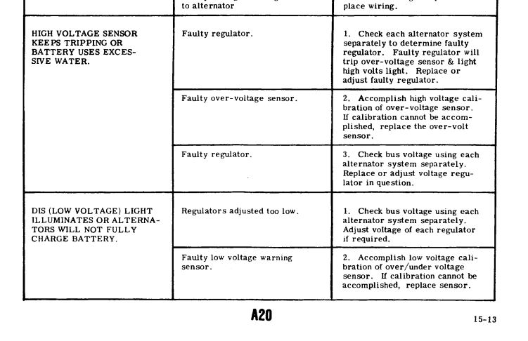

Pertinent Shop Manual Pages
I've attached all the pertinent shop manual pages for your perusal.
Unread 09-06-22, 01:16 PM
Since we're limited to 5 attachments per post, this is the 6th and final attachment from the previous post.
